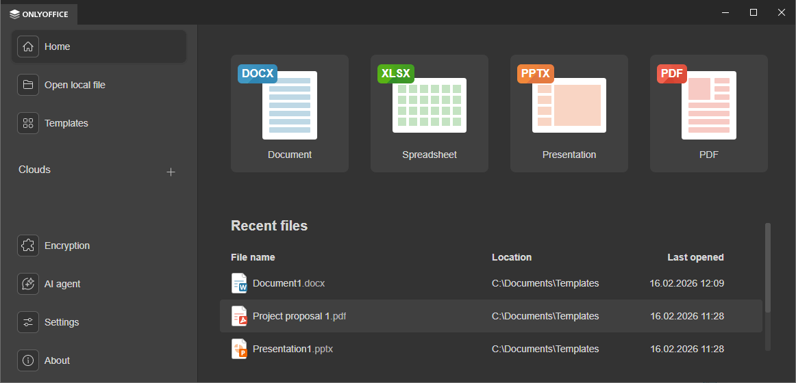

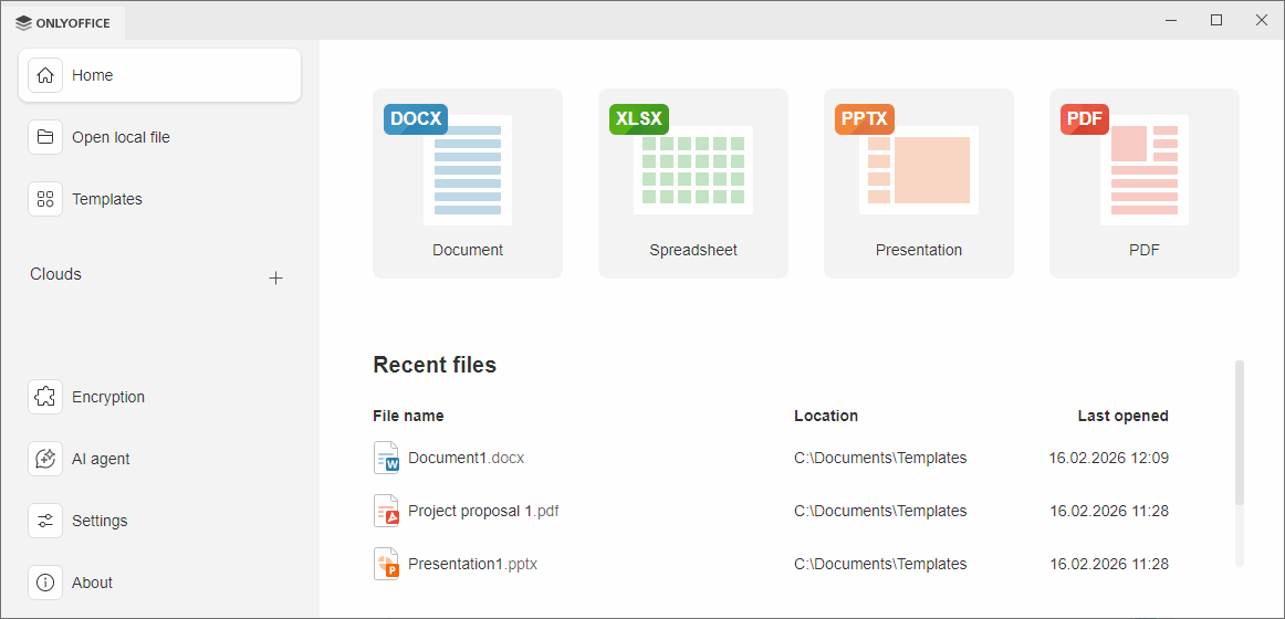

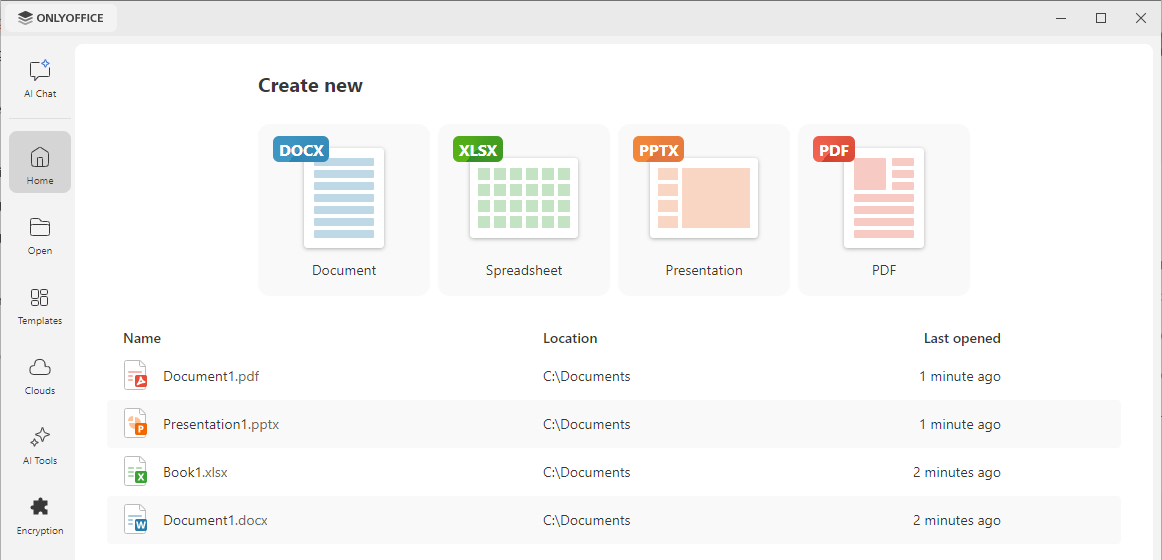

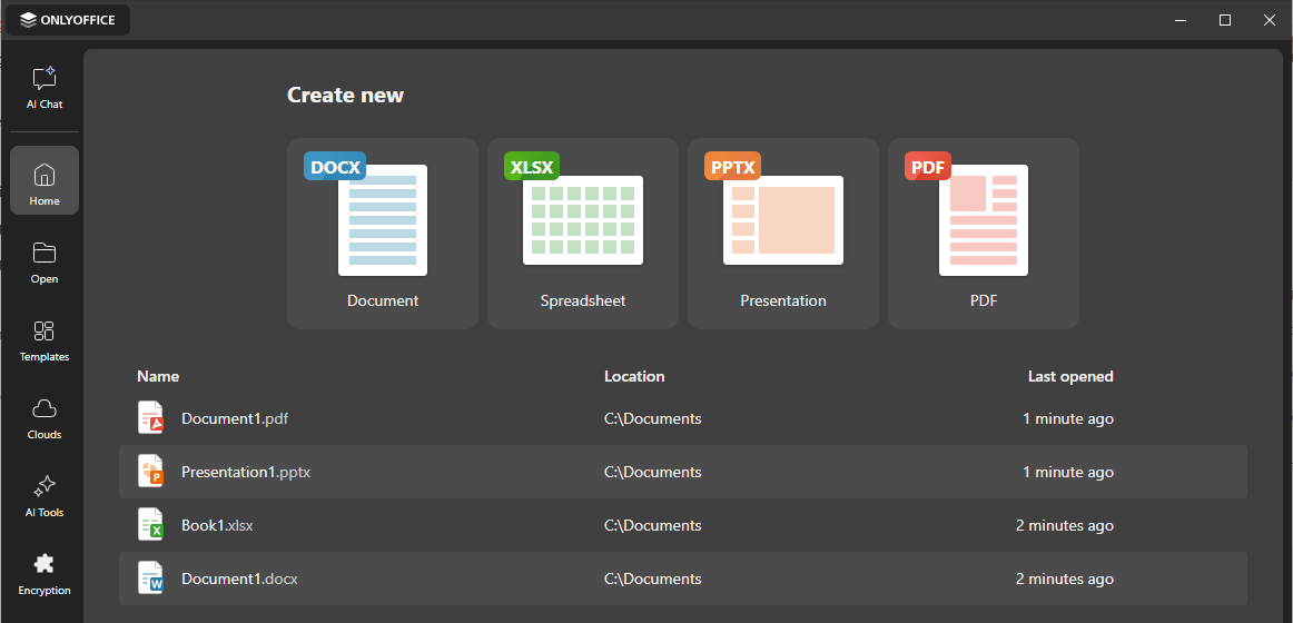

With it, we will get a new tab called Encryption on the main app page:
Encryption enabledEncryption enabled
Enable encryption by ticking the checkbox:
