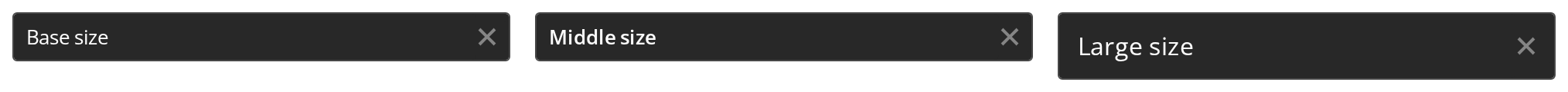

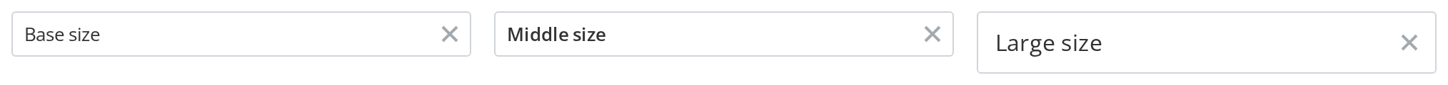

Sizes​
Match the search field to the inputs around it: Base size and Middle size share the 13px text, Large size is taller with 16px text (size).
SizesSizes

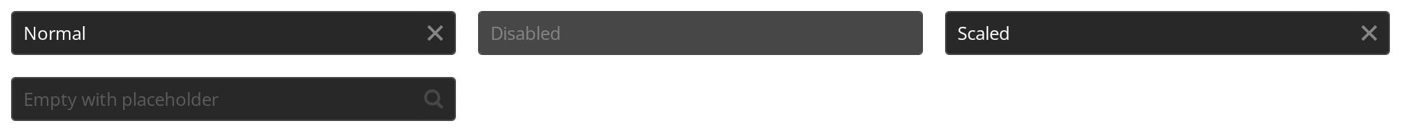

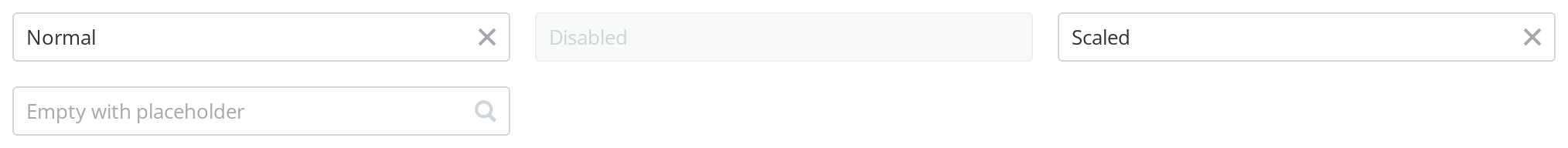

States​
The looks a search field takes on a page. Normal holds text, so it shows the cross that clears it. Disabled is greyed, cannot be typed into and shows neither magnifier nor cross (isDisabled). Scaled fills the width of its container (scale); in this grid every field already fills its cell, so the difference shows in a wider container. Empty with placeholder shows the magnifier and the placeholder text.
StatesStates

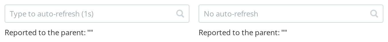

Auto Refresh Mode​
Decide how the parent hears about the search term. Type into Type to auto-refresh (1s): the line under it catches up a second after you stop (autoRefresh, refreshTimeout). Type into No auto-refresh: the line under it never changes, because with autoRefresh off the component does not call onChange at all.
Auto Refresh ModeAuto Refresh Mode

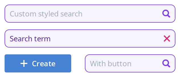

Css Customization​
Every overridable variable set on one wrapper -- the variables are listed under CSS variables on this page.
Custom styled search is empty and shows the magnifier color; With value holds text and shows the cross color; With button carries the main button, for the gap. Hover a field and click into it to see the two other border colors.
Css CustomizationCss Customization
