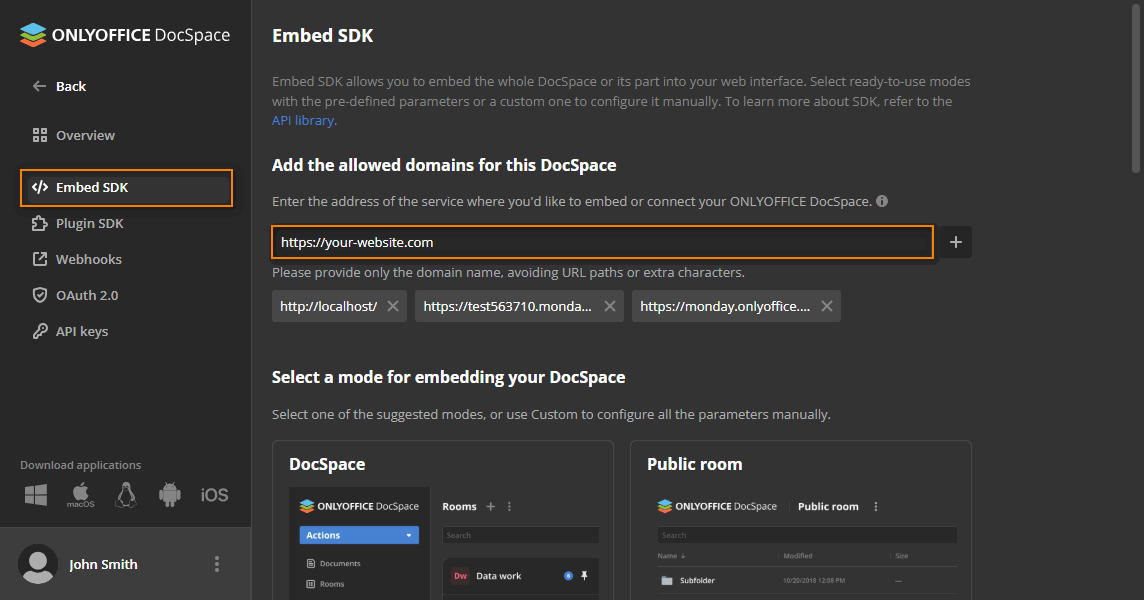

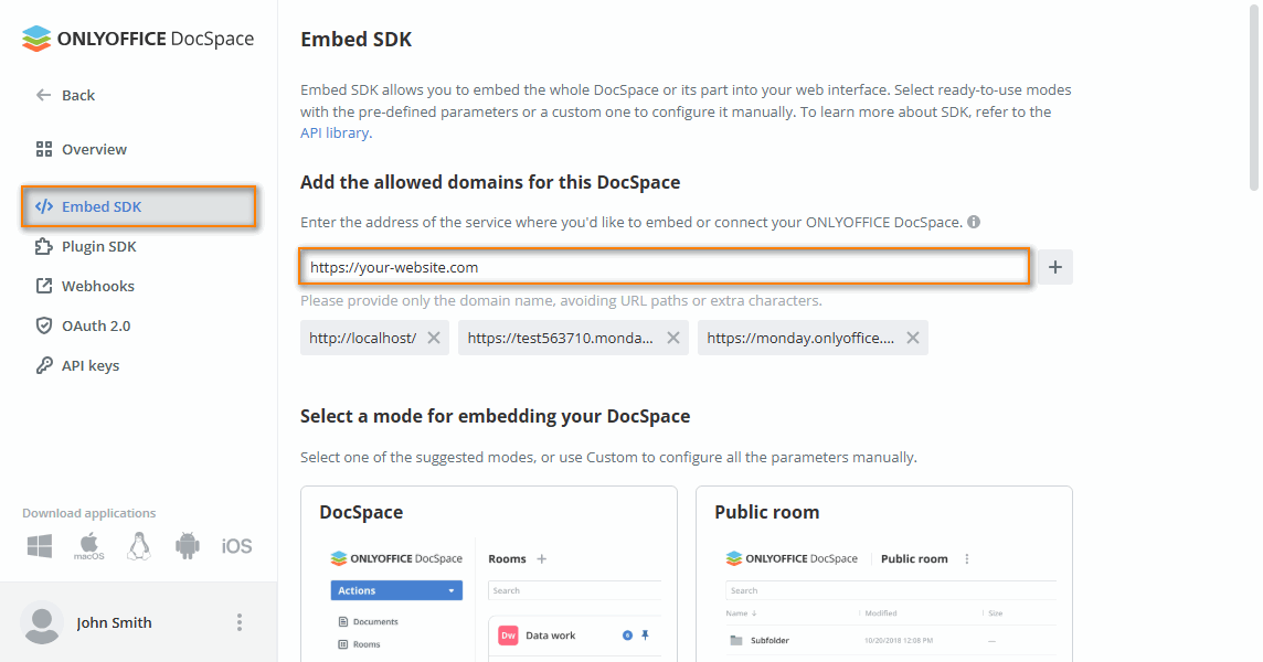

Registering allowed embed origins​
For the Embed SDK to work correctly, it must be launched on the server. Note that running the HTML file directly will not work. Please make sure you are using a server environment.
You need to add the URL of your server's root directory to the Developer Tools section of ONLYOFFICE Apps:
  1. Click the Developer Tools banner at the bottom of the left panel.
  2. Select Embed SDK in the left menu.
  3. In the Enter the address of ONLYOFFICE Apps to embed field, add the URL of your server's root directory.
Developer Tools URL whitelistDeveloper Tools URL whitelist
Only exact origins are matched — subdomains and paths are not automatically included. Add each distinct origin separately.
