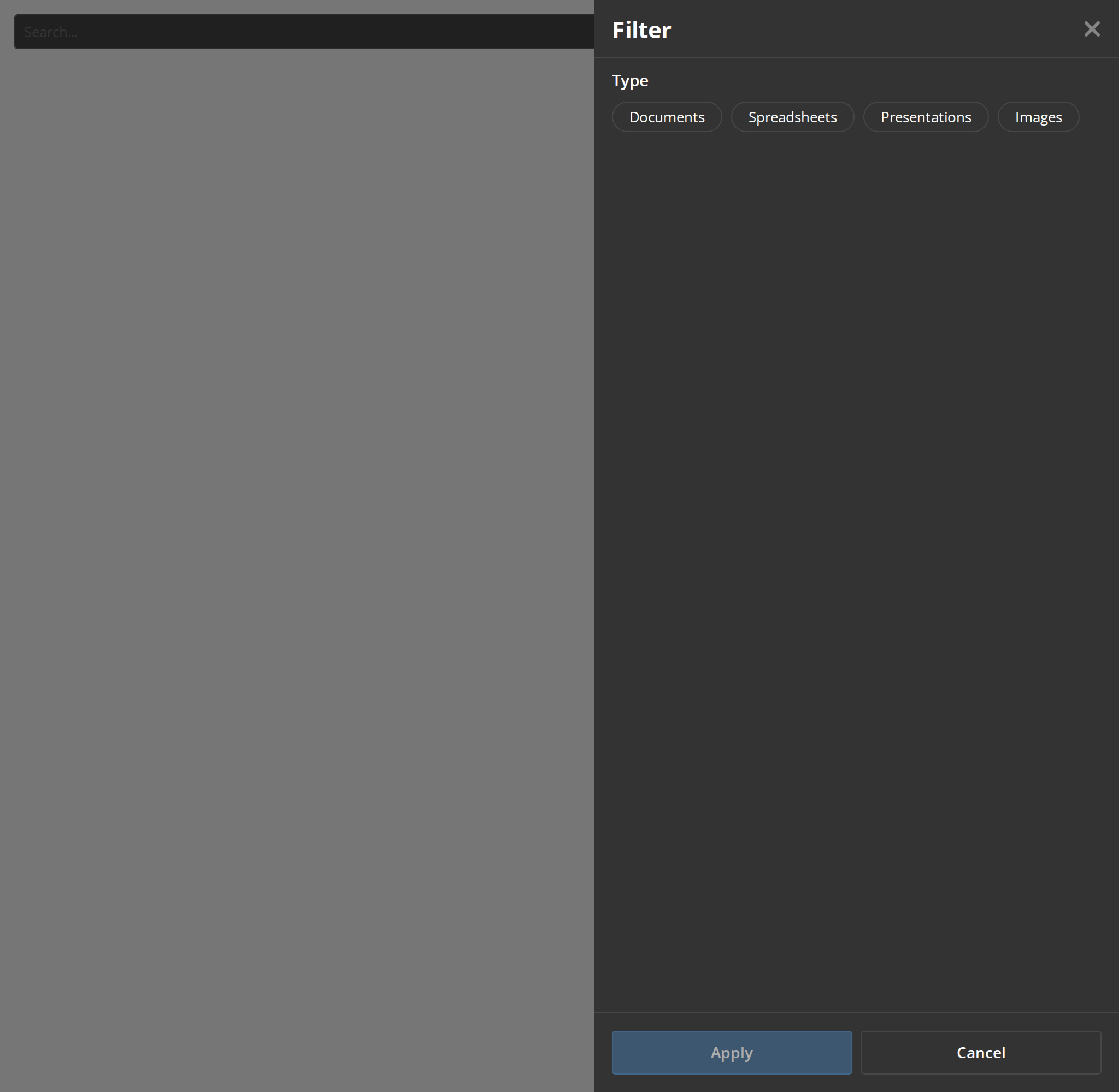

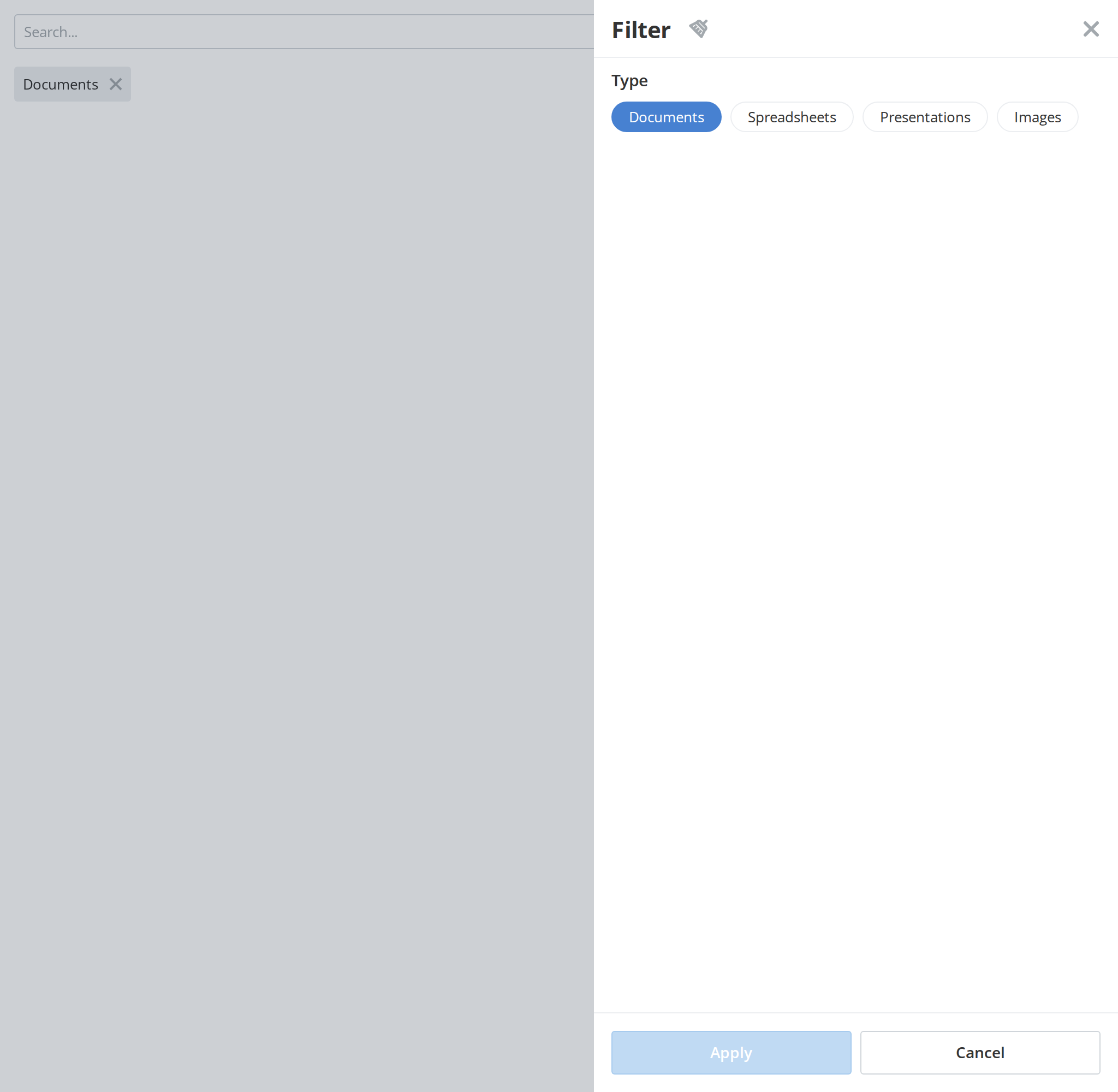

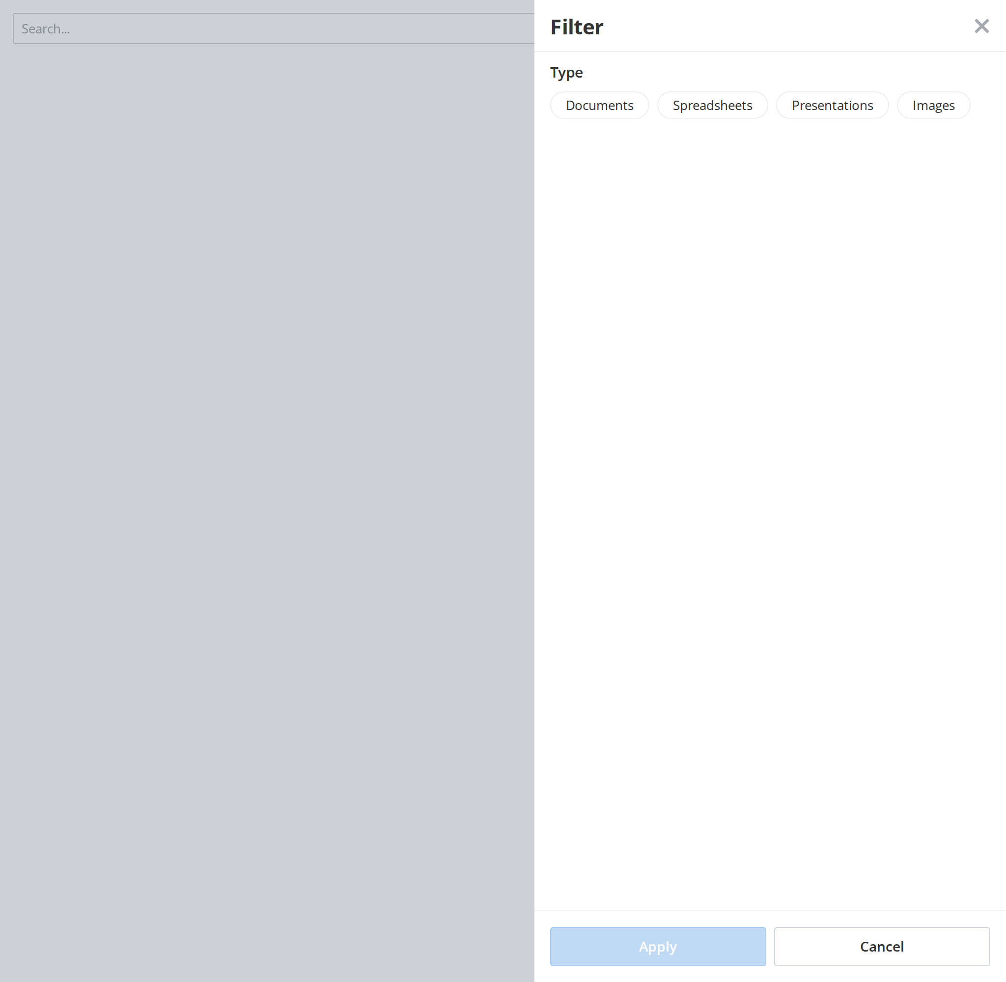

Document Types​
The filter panel with one group of options, opened for you when the story loads. Pick a type and press Apply to see the selection reach onFilter in the Actions panel.
Document TypesDocument Types

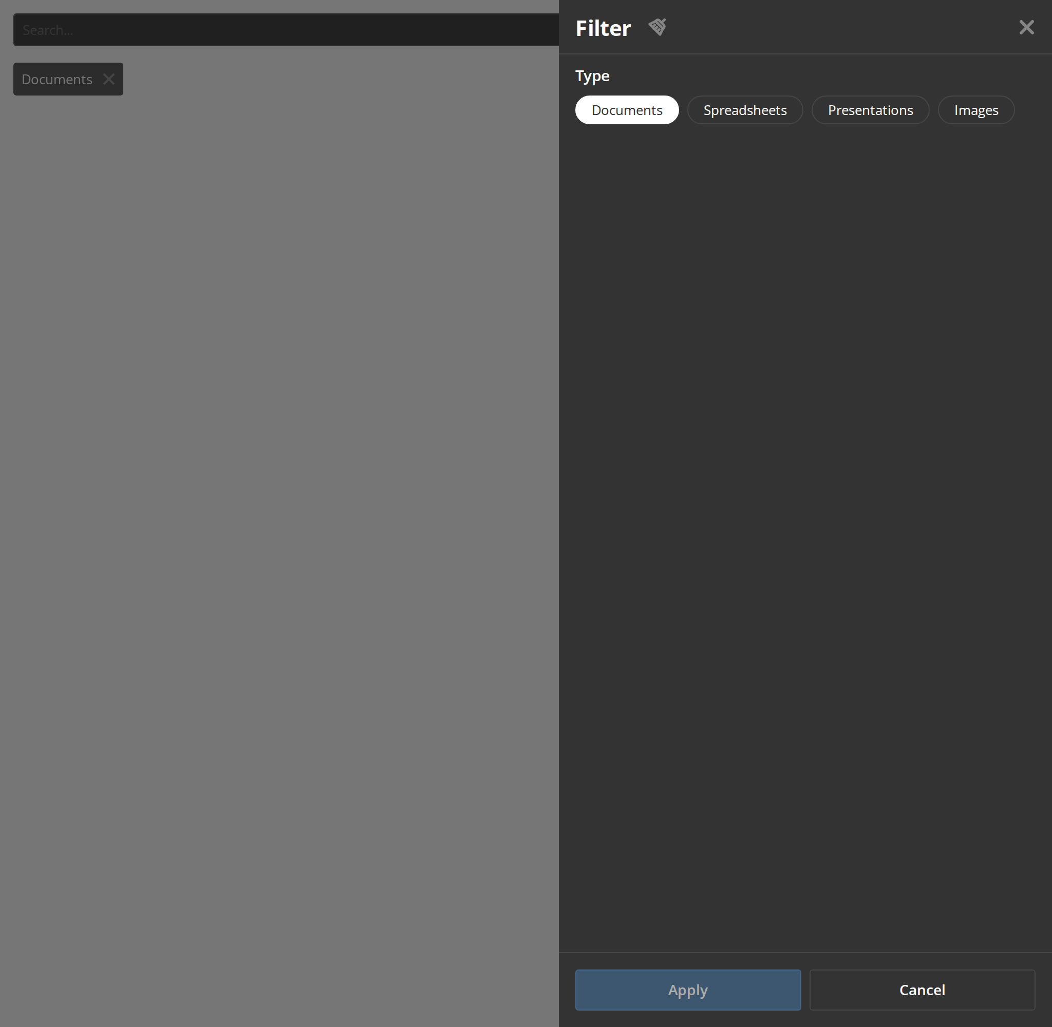

With Selected Filters​
A filter already in force when the bar mounts: its chip is under the search box and its option is highlighted in the panel, opened for you when the story loads (initSelectedFilterData). Apply stays disabled until the selection changes.
With Selected FiltersWith Selected Filters

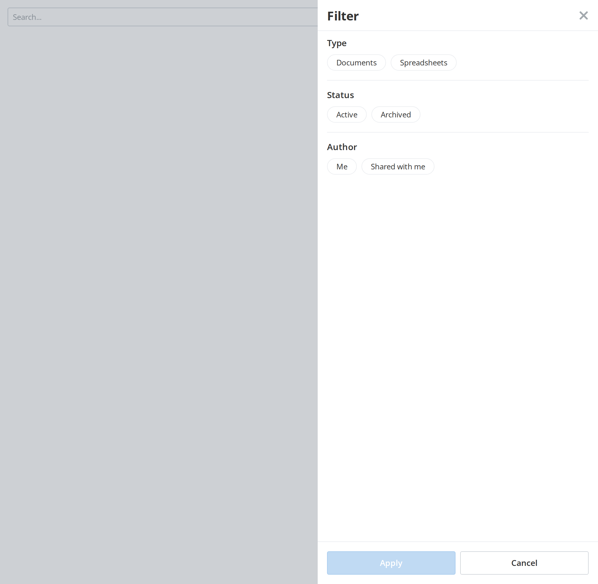

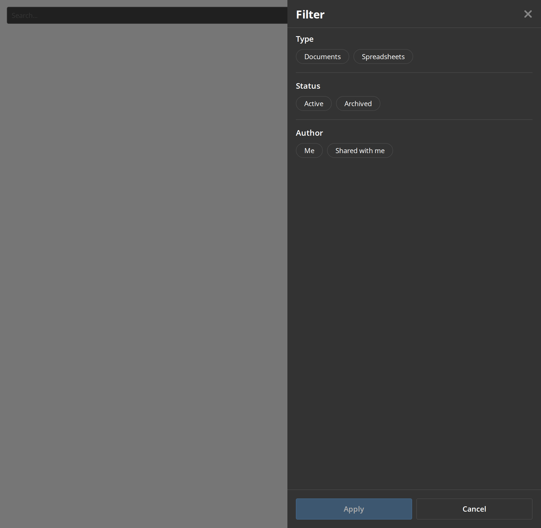

Multiple Filter Groups​
Several groups in one panel, each under its heading and divided by a line, so a listing can be narrowed by type, status and author at once. The panel opens for you when the story loads; one option can be picked per group.
Multiple Filter GroupsMultiple Filter Groups

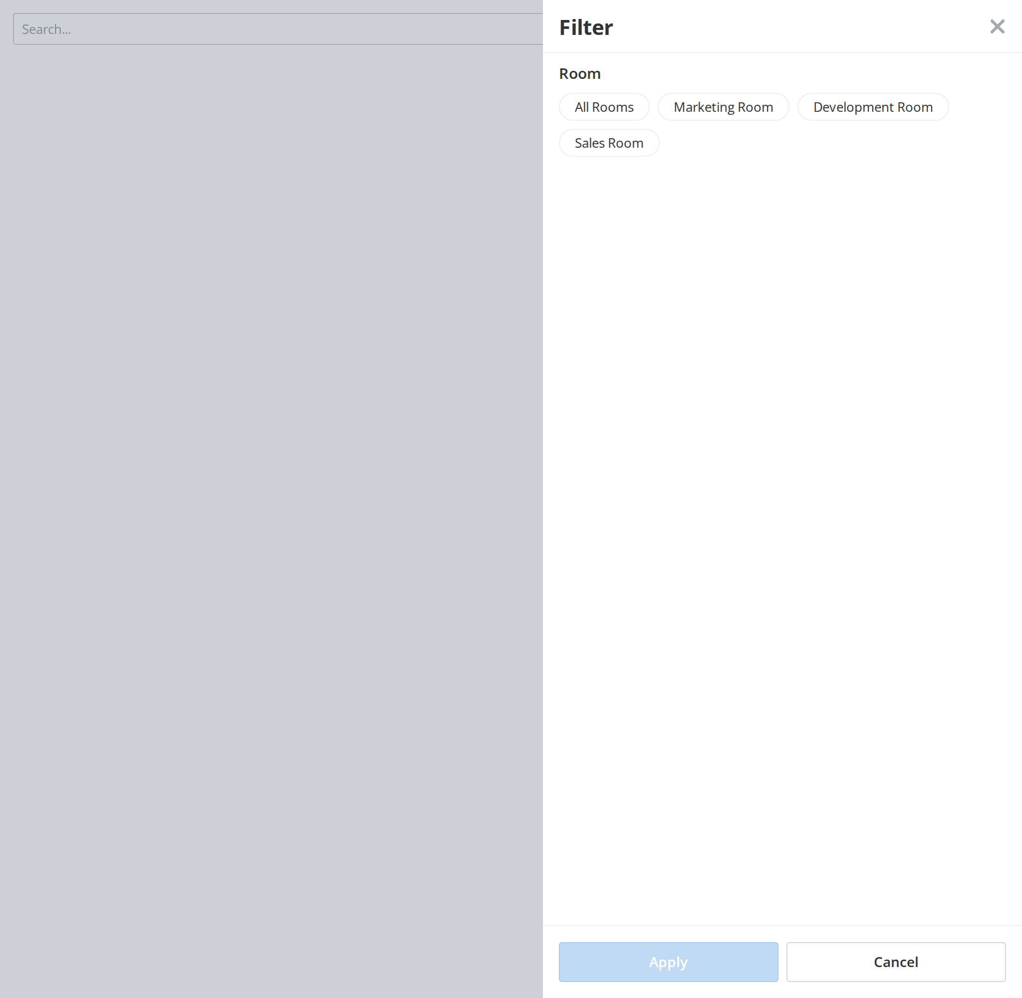

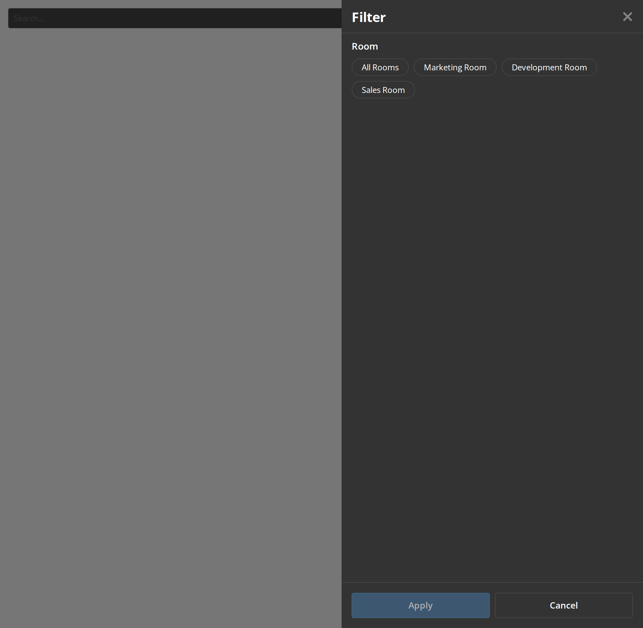

Rooms Filter​
The panel of a listing of rooms: it shows a loading skeleton for half a second before the options appear, and passes the rooms flag on to renderSelector (isRooms). The panel opens for you when the story loads.
Rooms FilterRooms Filter

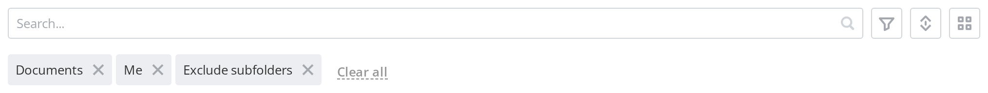

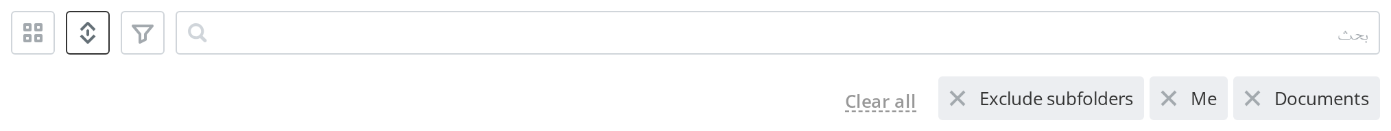

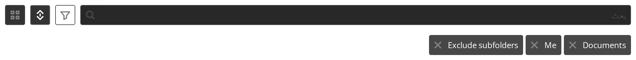

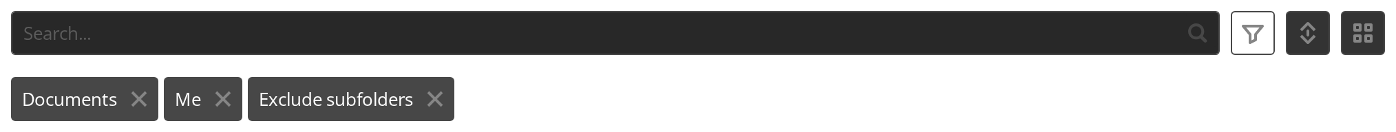

With Filter Chips​
The filters in force as chips under the bar, so the reader sees what narrows the listing and can drop any of it in one click. Click a chip to remove it (removeSelectedItem); the "Clear all" link appears once more than one chip is shown (clearAll).
With Filter ChipsWith Filter Chips

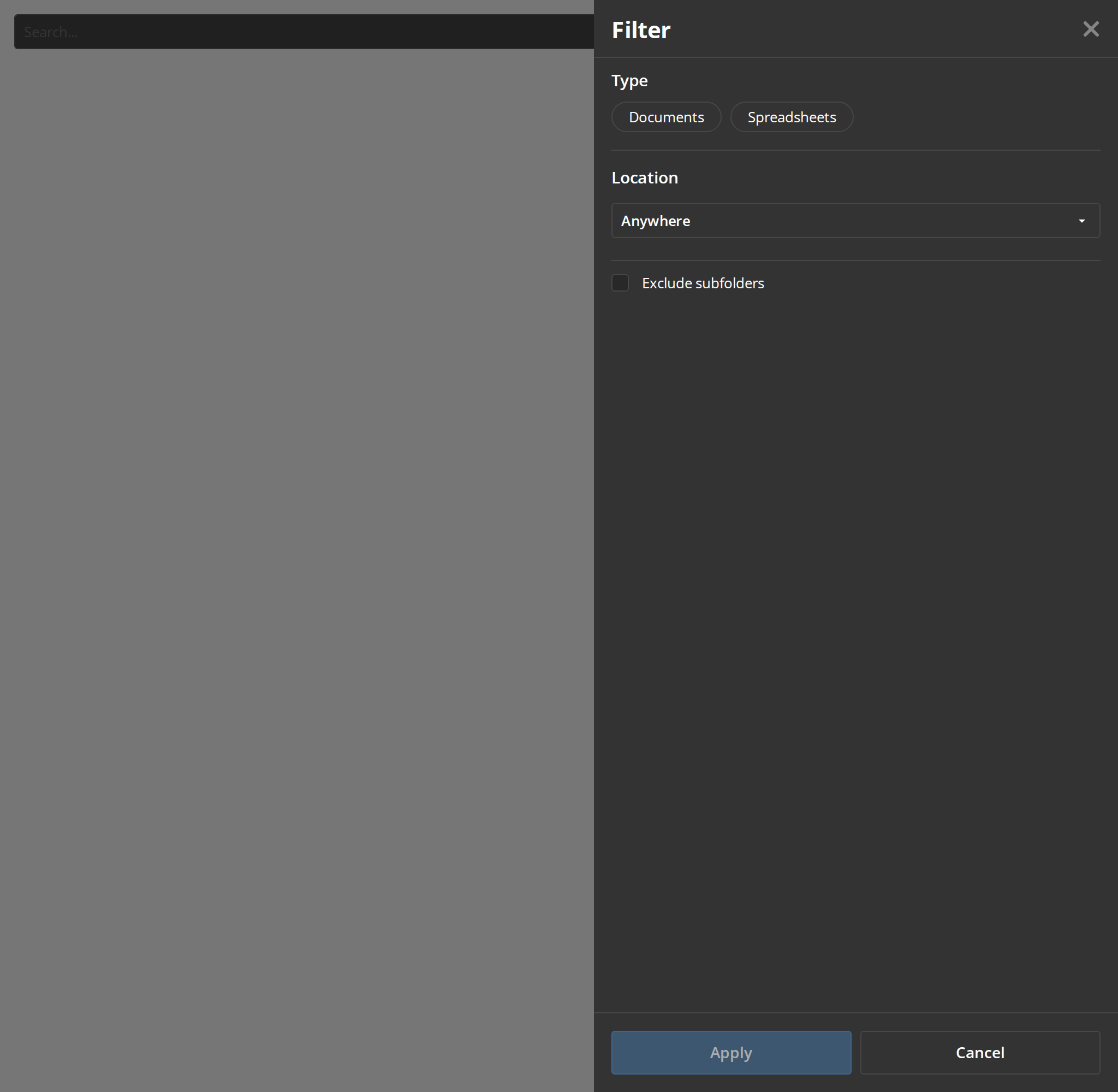

Panel Option Kinds​
The kinds of option a group can hold besides tags, for filters that are not a choice among a few words. The panel opens for you when the story loads:
  • Documents, Spreadsheets — tags, one of which can be picked
  • Anywhere — a drop-down list of values (withOptions with options)
  • Exclude subfolders — a checkbox, in a group without a heading (isCheckbox, withoutHeader)
Panel Option KindsPanel Option Kinds

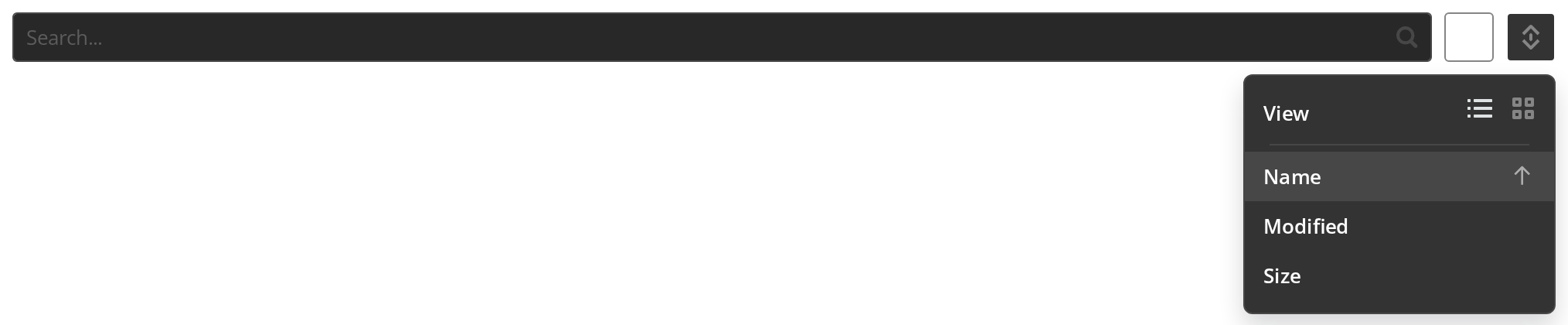

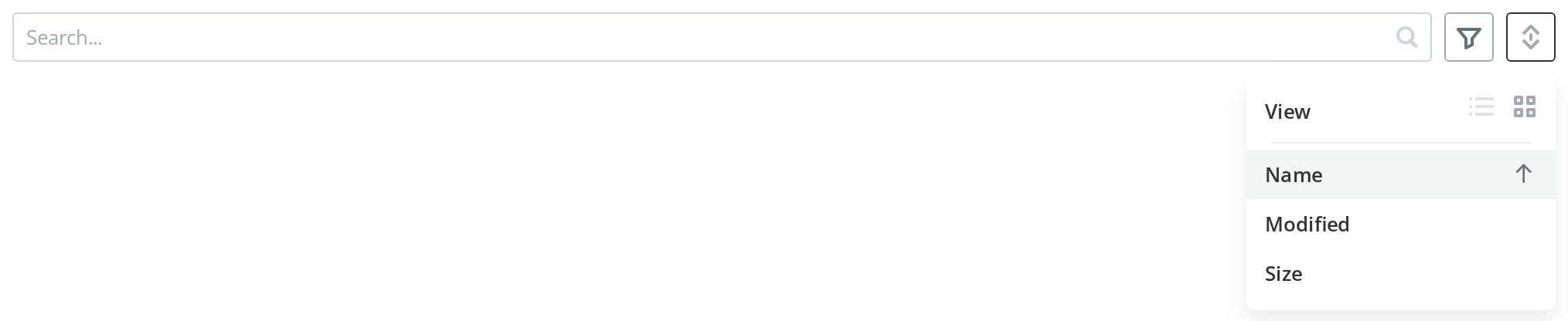

Sort Menu On Tablet​
The sort menu on a device narrower than a desktop, opened for you when the story loads: the view switch has left the bar and heads the menu, above the sort fields (currentDeviceType). The current field carries an arrow for its direction; pick it again to reverse it (onSort).
Sort Menu On TabletSort Menu On Tablet

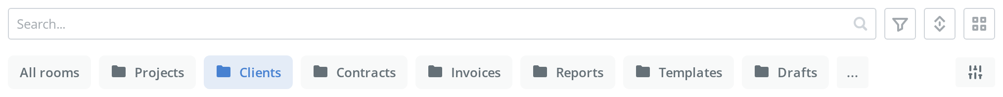

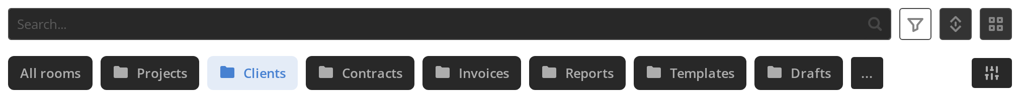

With Grouping Row​
A row of group chips under the bar, for a listing its host has sorted into groups: "All rooms" first, the chosen group highlighted (currentGroupId), and the groups that do not fit behind the "..." button. Click a chip to choose it (onFilterByGroup); the button at the end of the row opens the host's group management (setEditRoomGroupsDialogVisible).
With Grouping RowWith Grouping Row

The chips under the bar​
The chips come from getSelectedFilterData, not from a prop. Removing one calls removeSelectedItem — and the component has already dropped the chip from its own list by then, so your model has to catch up rather than confirm.
import { useCallback, useState } from "react";
import FilterInput from "@onlyoffice/apps-ui-kit/components/filter";
import type { TItem } from "@onlyoffice/apps-ui-kit/components/filter";
import { DeviceType, FilterGroups } from "@onlyoffice/apps-ui-kit/enums";
export function FilterWithChips() {
const [items, setItems] = useState<TItem[]>([
{ key: "docx", label: "Documents", group: FilterGroups.filterType },
const getSelectedFilterData = useCallback(() => items, [items]);
const empty = useCallback(() => [], []);
const emptyAsync = useCallback(async () => [], []);
const getSelectedSortData = useCallback(
() => ({ sortDirection: "asc" as const, sortId: "AZ" as const }),
return (
<FilterInput
placeholder="Search"
onSearch={() => {}}
onClearFilter={() => {}}
clearSearch={false}
setClearSearch={() => {}}
getSelectedInputValue={useCallback(() => "", [])}
getSelectedFilterData={getSelectedFilterData}
getViewSettingsData={empty}
getFilterData={emptyAsync}
getSortData={empty}
getSelectedSortData={getSelectedSortData}
onFilter={() => {}}
onSort={() => {}}
onSortButtonClick={() => {}}
onChangeViewAs={() => {}}
removeSelectedItem={({ key }) =>
setItems((rest) => rest.filter((item) => item.key !== key))
clearAll={() => setItems([])}
view="files"
viewAs="row"
viewSelectorVisible={false}
filterHeader="Filter"
selectorLabel="Select"
filterTitle="Filter"
sortByTitle="Sort by"
userId="1"
currentDeviceType={DeviceType.desktop}
isIndexing={false}
isIndexEditingMode={false}
isRecentFolder={false}
isRooms={false}
isContactsPage={false}
isContactsPeoplePage={false}
isContactsGroupsPage={false}
isContactsInsideGroupPage={false}
isContactsGuestsPage={false}

  • The filter panel works on a copy. It opens as a side panel of grouped options — tags, checkboxes, toggles, drop-down lists and selector steps — and the whole selection reaches onFilter only when Apply is pressed; closing it discards the changes. The one exception is the clear icon in the panel's header, which calls onFilter([]) at once when filters were in force.
  • The sort menu marks the current field with an arrow pointing in the current direction; picking that field again reverses the direction, and picking another keeps it.
  • The sort button disappears whenever isIndexing, isFlowsPage or isRecentFolder is set, and the filter button whenever isIndexEditingMode or isFlowsPage is; isIndexEditingMode also disables the search box.
  • The view selector is in two places. On a desktop it is a single button beside the sort button that offers the view you are not in; below that breakpoint it is rendered inside the sort menu instead, and viewSelectorVisible governs both.
  • viewAs="table" is quietly treated as "row" by the sort menu and the view selector.
  • The room grouping row needs four things at once: withRoomGroups, organizeRoomsGrouping, a resolved getAllRoomGroups, and isFilterOrSearchActive unset. Only groups whose icon is an object survive — a string or null icon drops the group — and the icon is an SVG source turned into a data URL.
  • That row measures itself in a hidden copy. Every chip is rendered twice, once off-screen, and the visible row appears only once those measurements are in; the overflow spills into a menu.

  • renderSelector is not optional in practice. Any filter group that picks a person or a room opens a step this package cannot fill.
