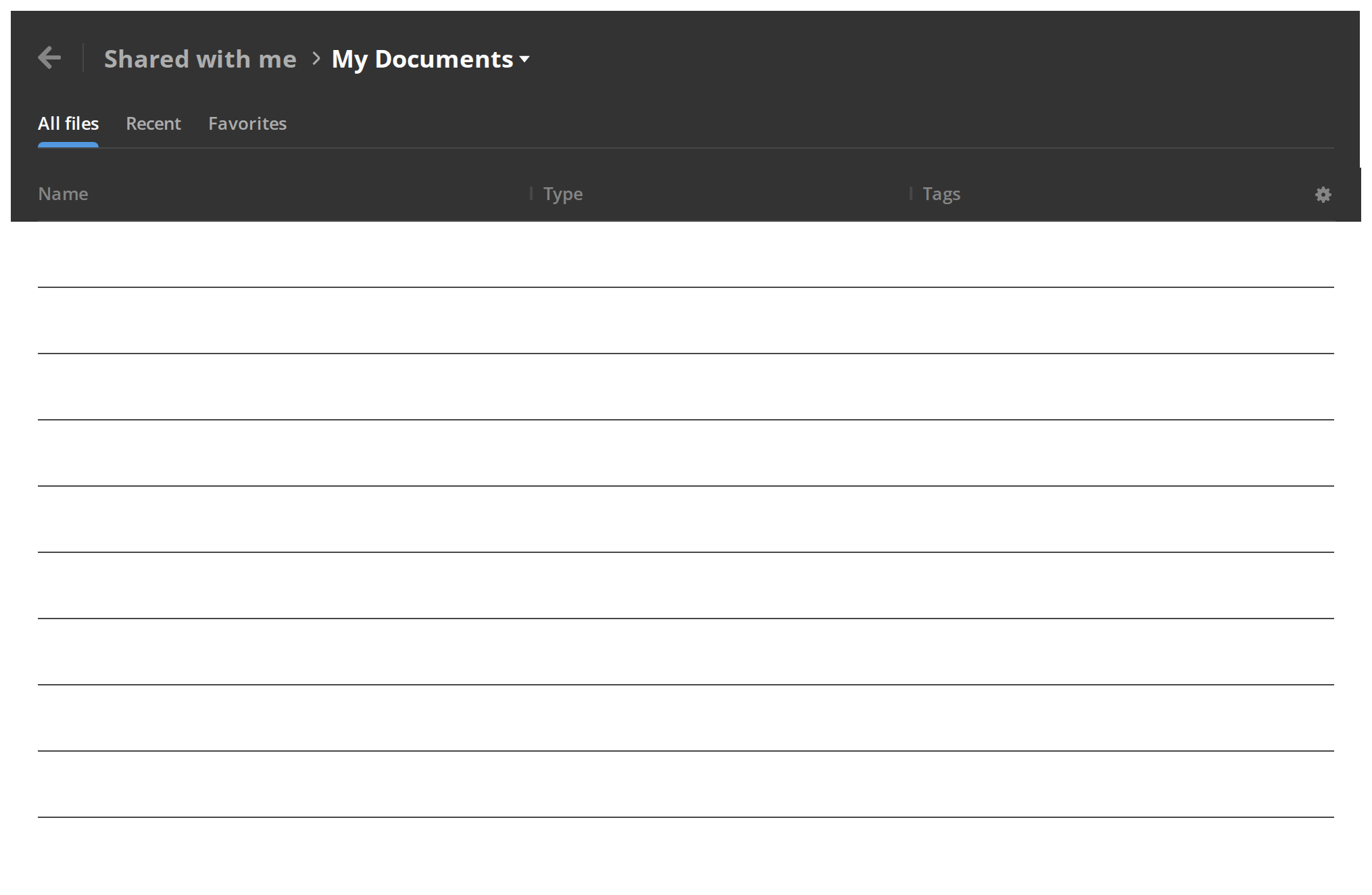

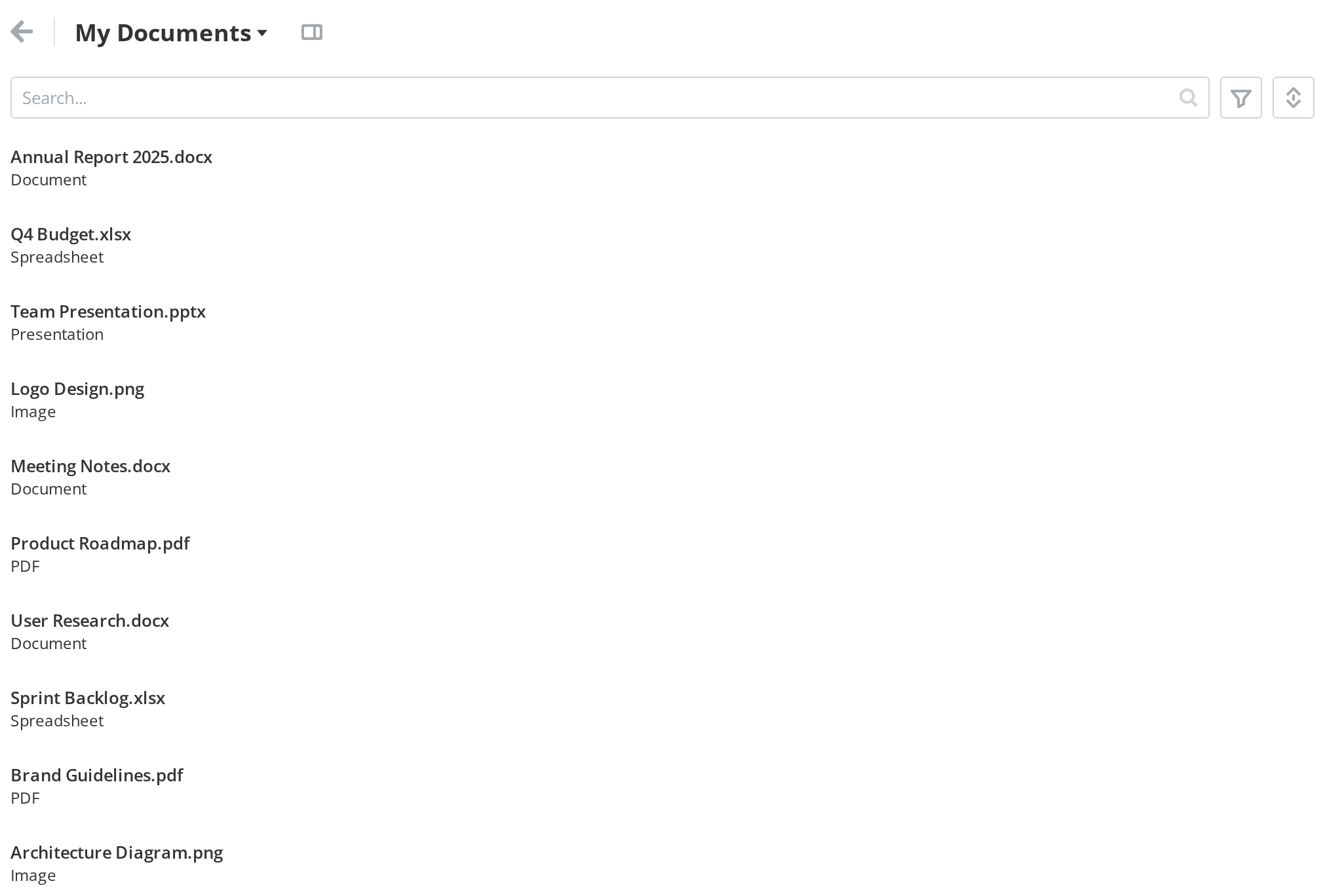

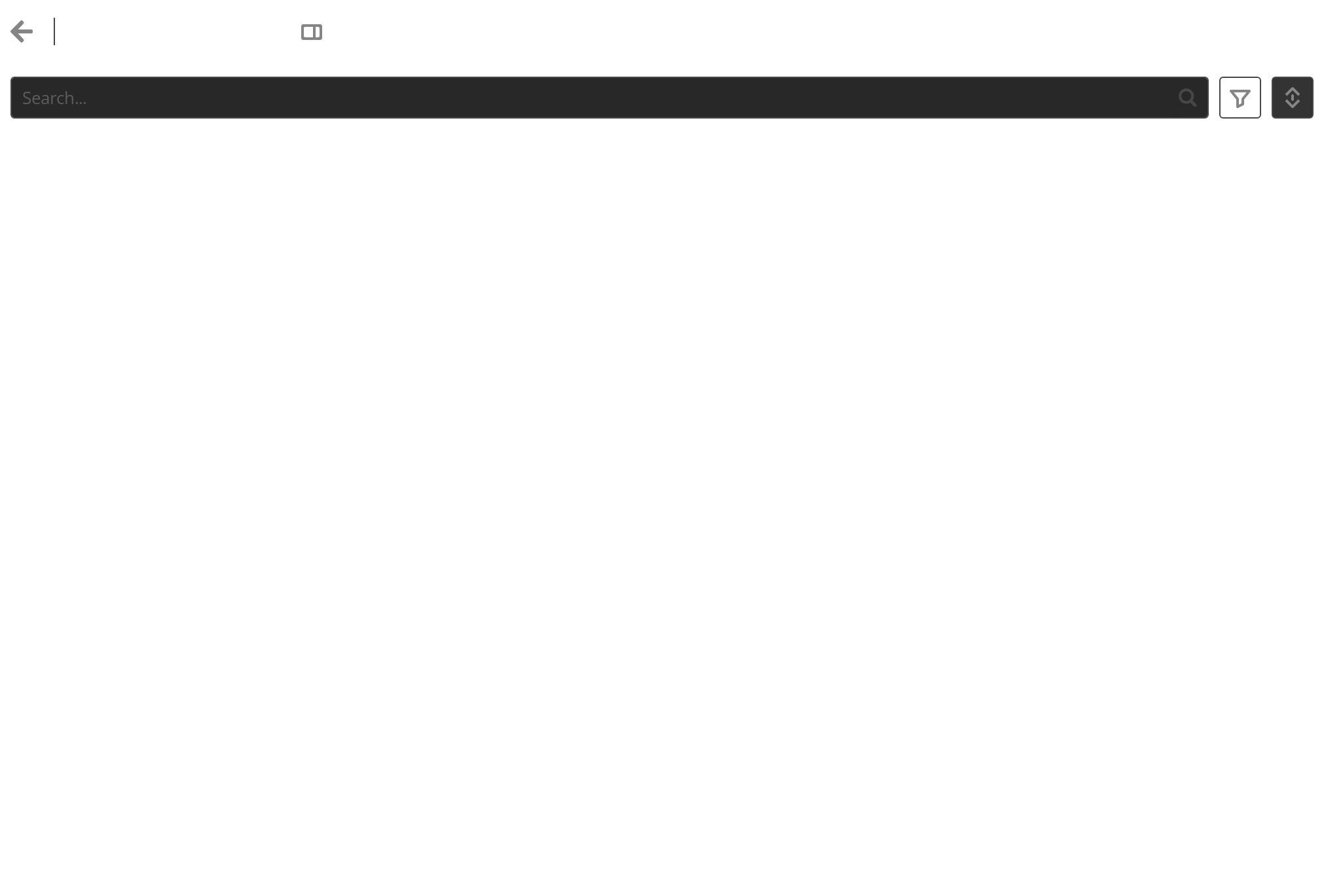

Default​
A whole page: breadcrumbs in the header, a search and filter bar under it and a table in the body, each outlined and labelled so you can see where the section puts its slots. Scroll the table to see the header and the filter stay pinned; change any other prop live in the Controls panel below.
DefaultDefault

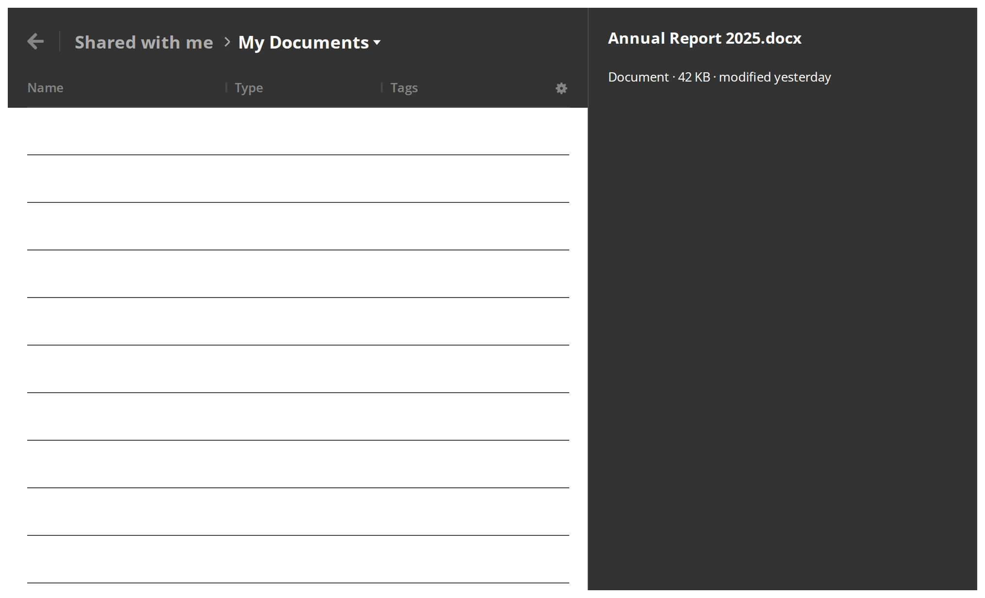

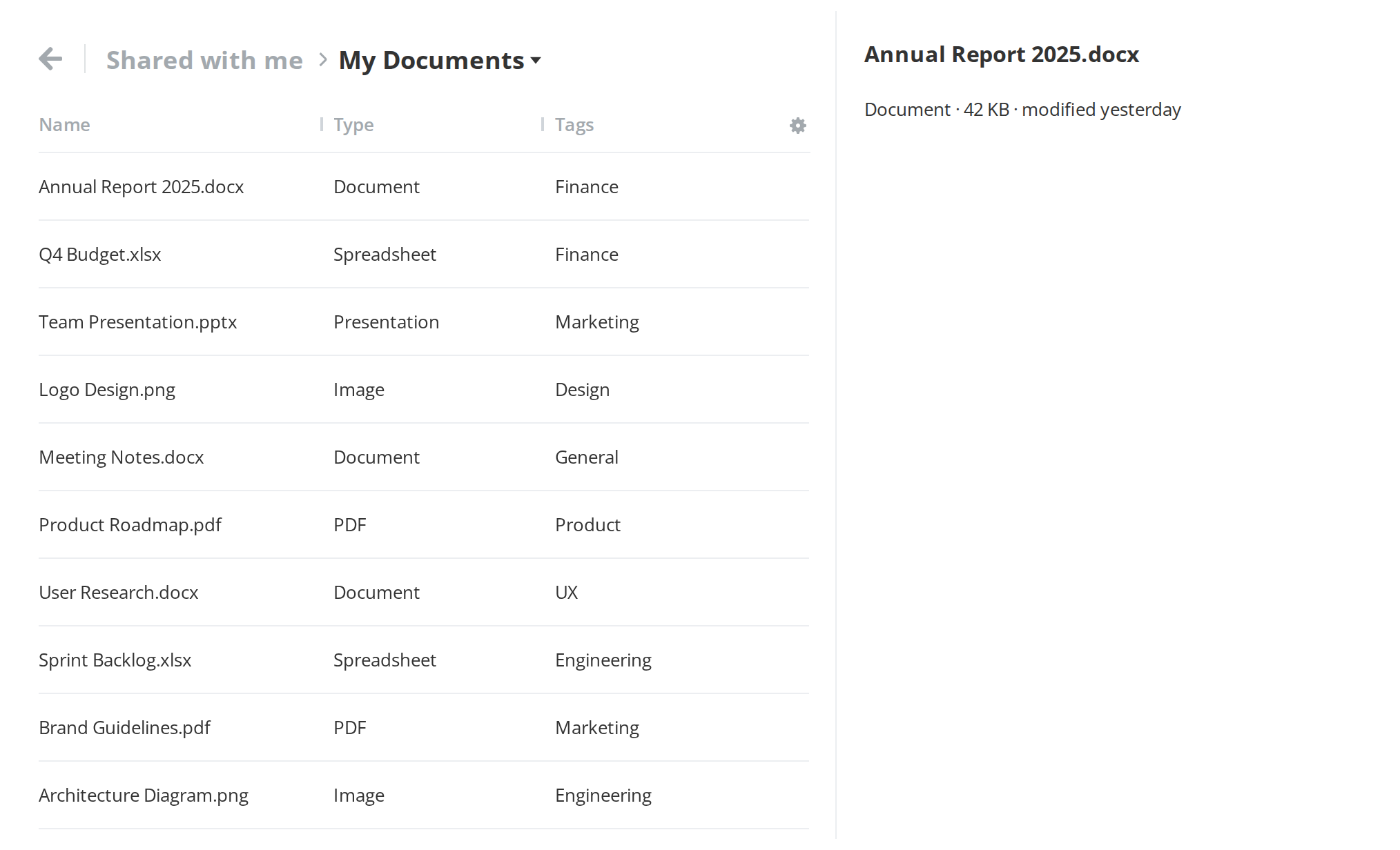

With Info Panel​
A details panel beside the listing, for the properties of the selected item without leaving the page. It shows only while both canDisplay and isInfoPanelVisible are on; switch either off in the Controls panel below to close it.
With Info PanelWith Info Panel

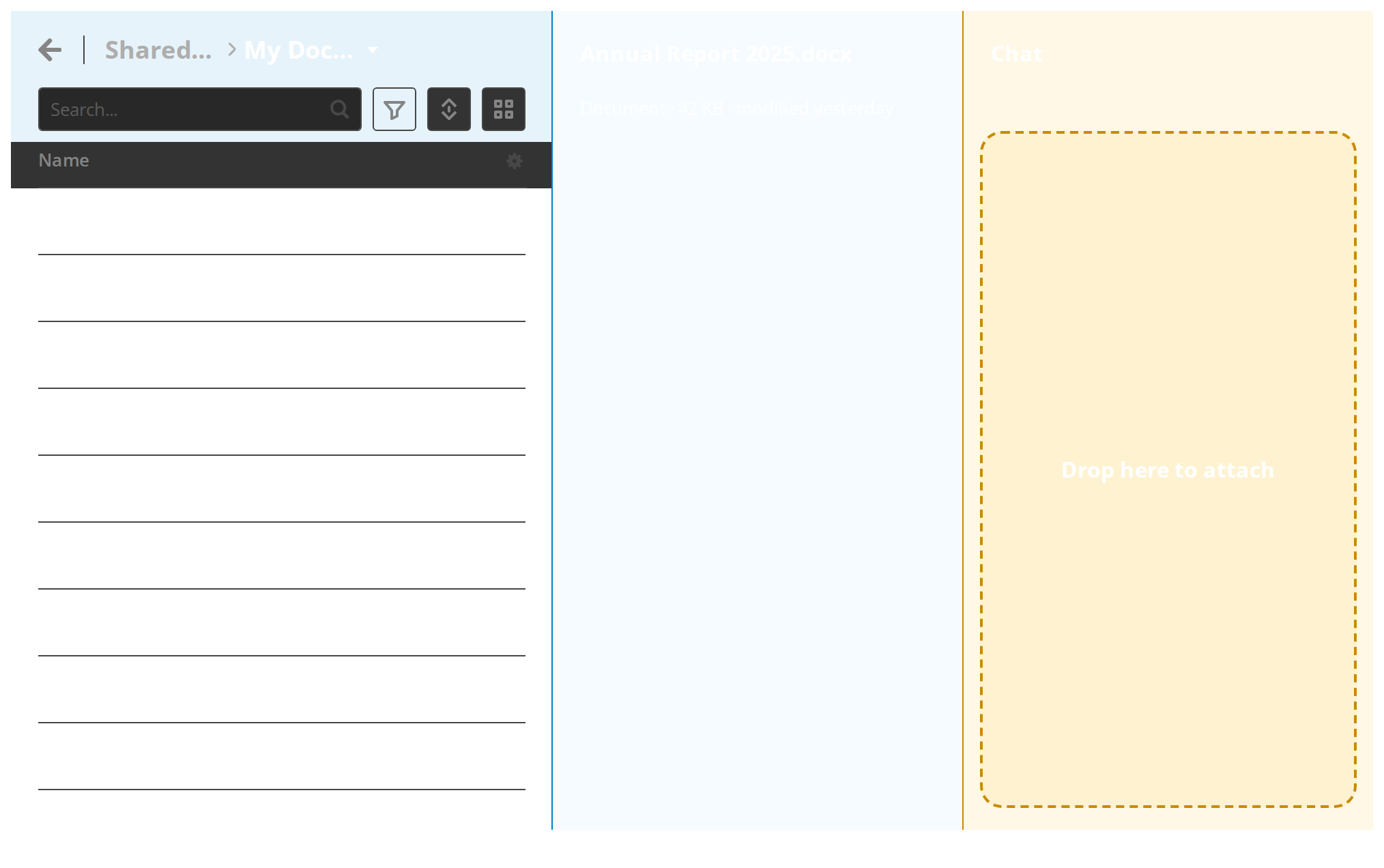

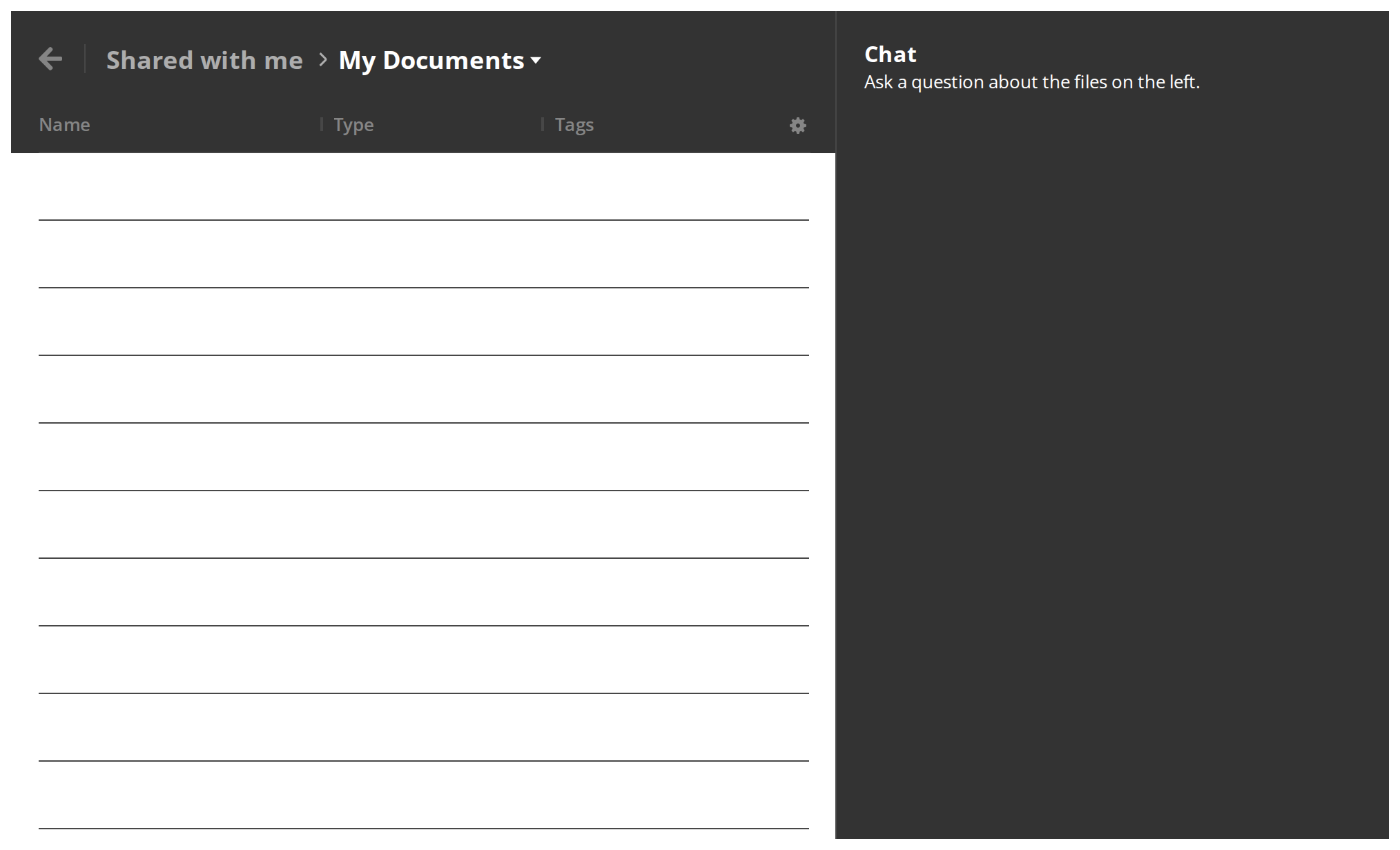

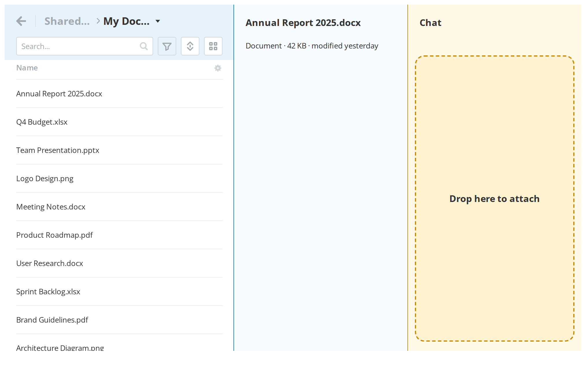

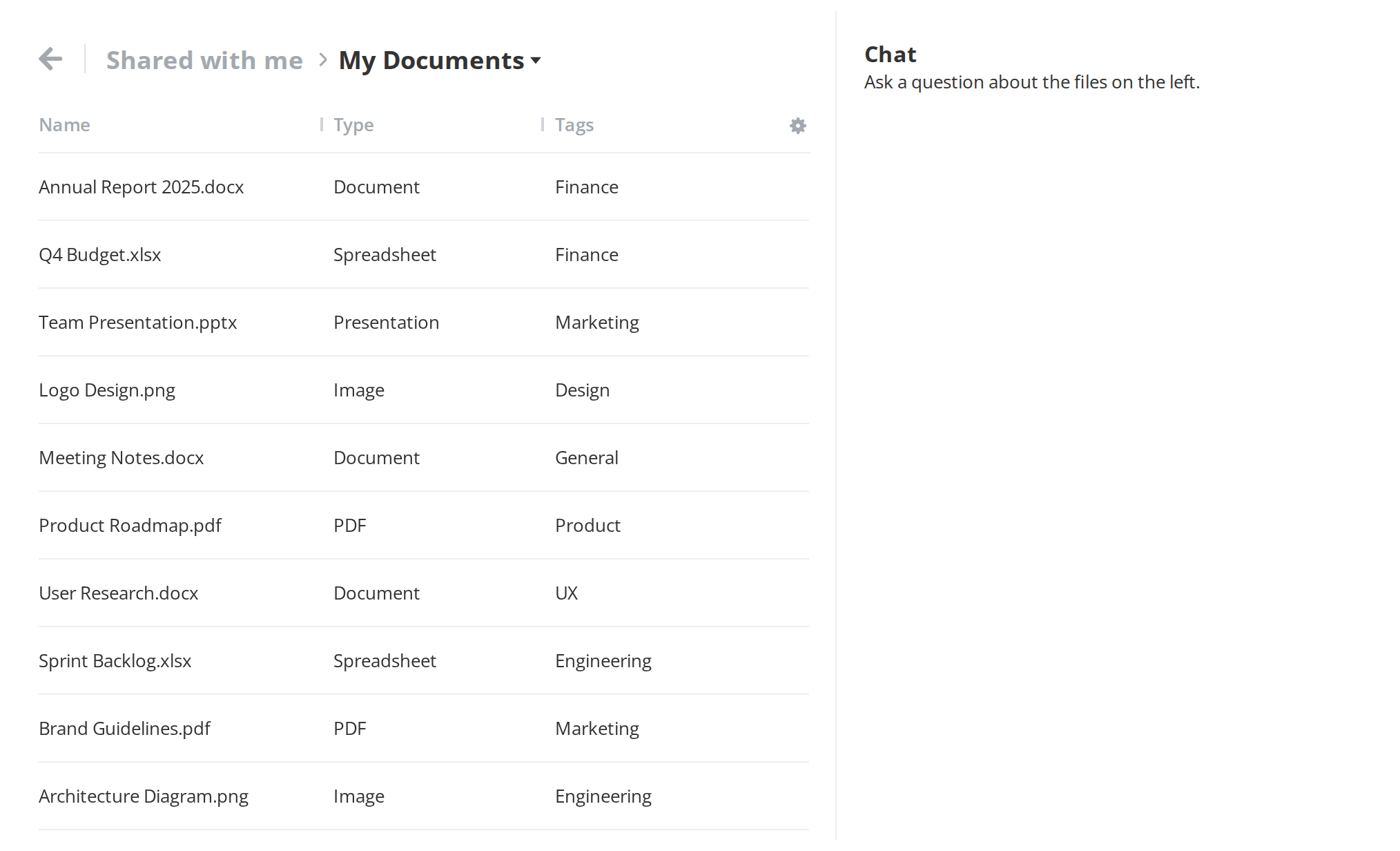

With Chat Panel​
A chat docked beside the listing, so a conversation about the files stays open while you work with them. Drag its inner edge to make it wider or narrower (isChatPanelResizable); the new width arrives when you release the mouse (setChatPanelWidth).
With Chat PanelWith Chat Panel

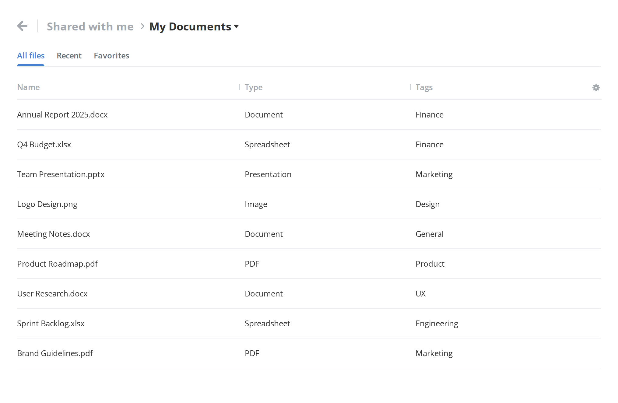

With Submenu​
Tabs under the header that switch between views of the same page and stay pinned with it while the listing scrolls (Section.SectionSubmenu).
With SubmenuWith Submenu

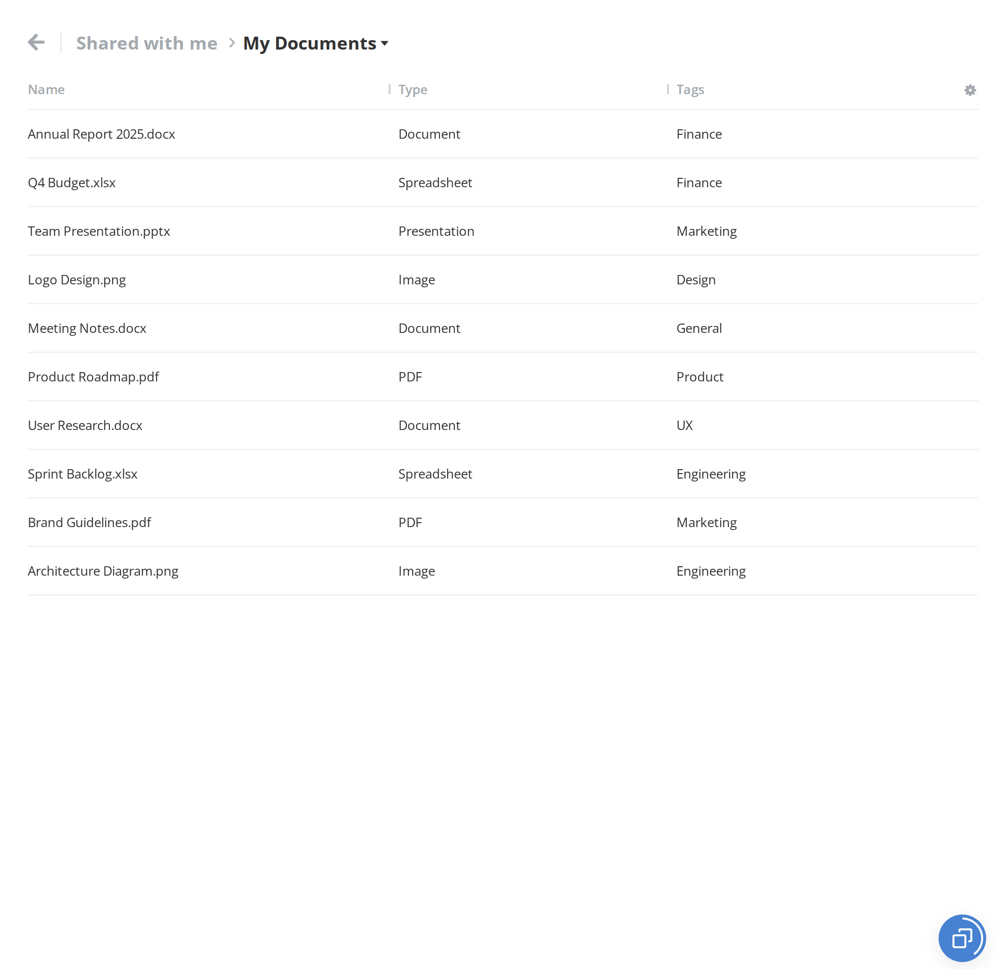

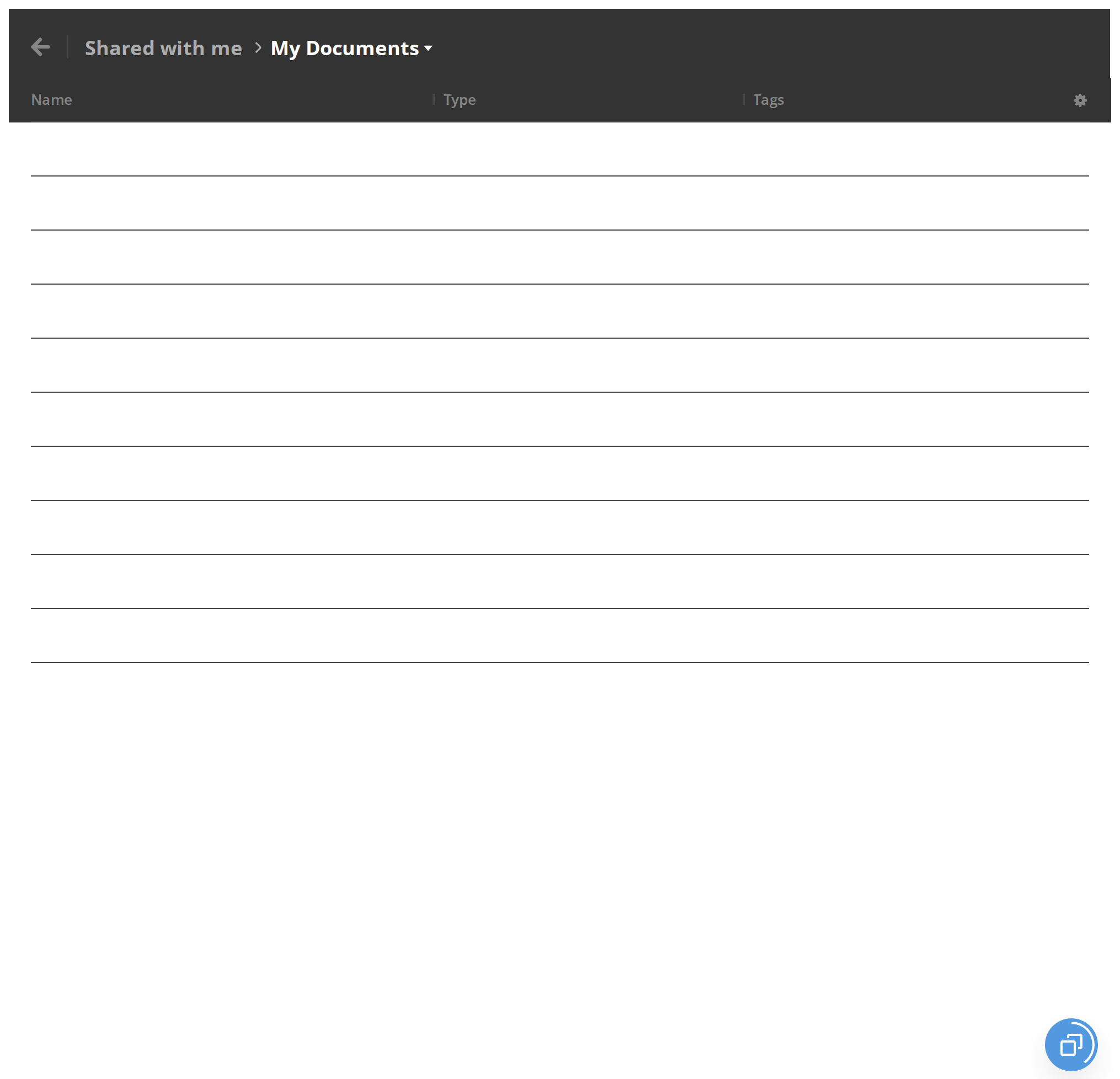

With Operations Progress​
A round progress button in the bottom corner, so a long copy or upload stays visible while the user goes on working (secondaryActiveOperations). Hover it to read what is running; an empty list hides it again.
With Operations ProgressWith Operations Progress

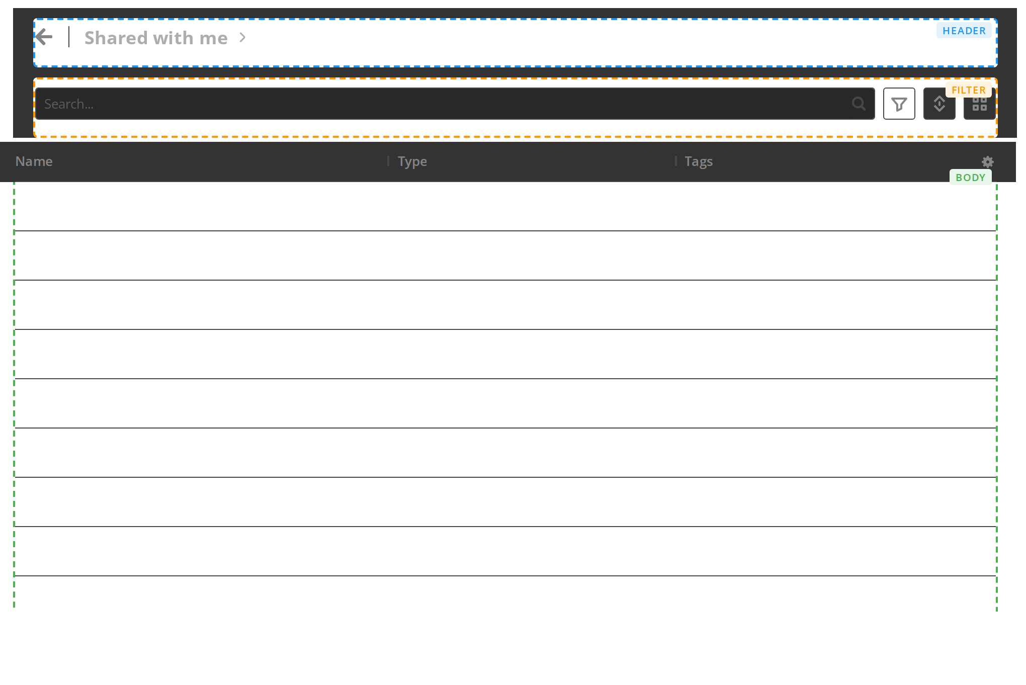

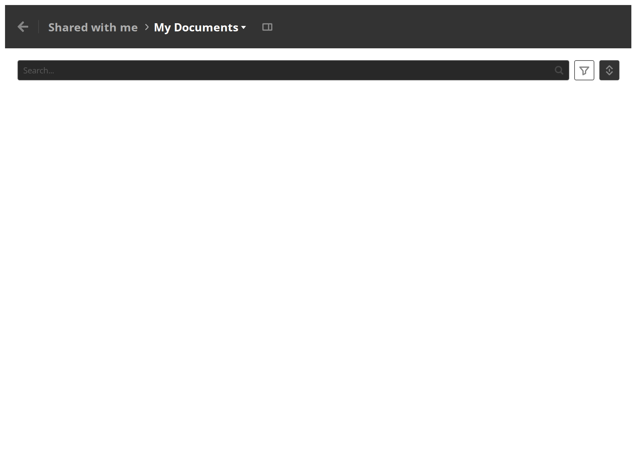

On Tablet​
The page in a tablet-width window: the header stays pinned, while the filter bar moves into the listing and scrolls with it, leaving more room for the rows (currentDeviceType).
On TabletOn Tablet

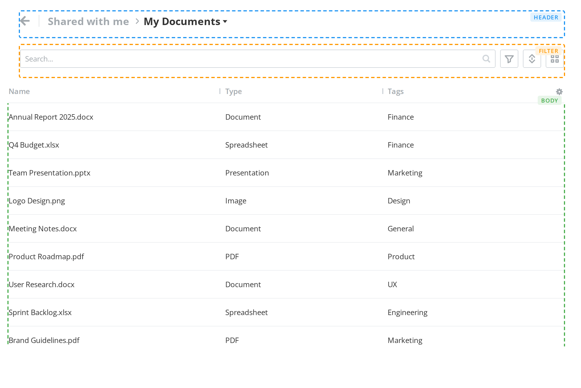

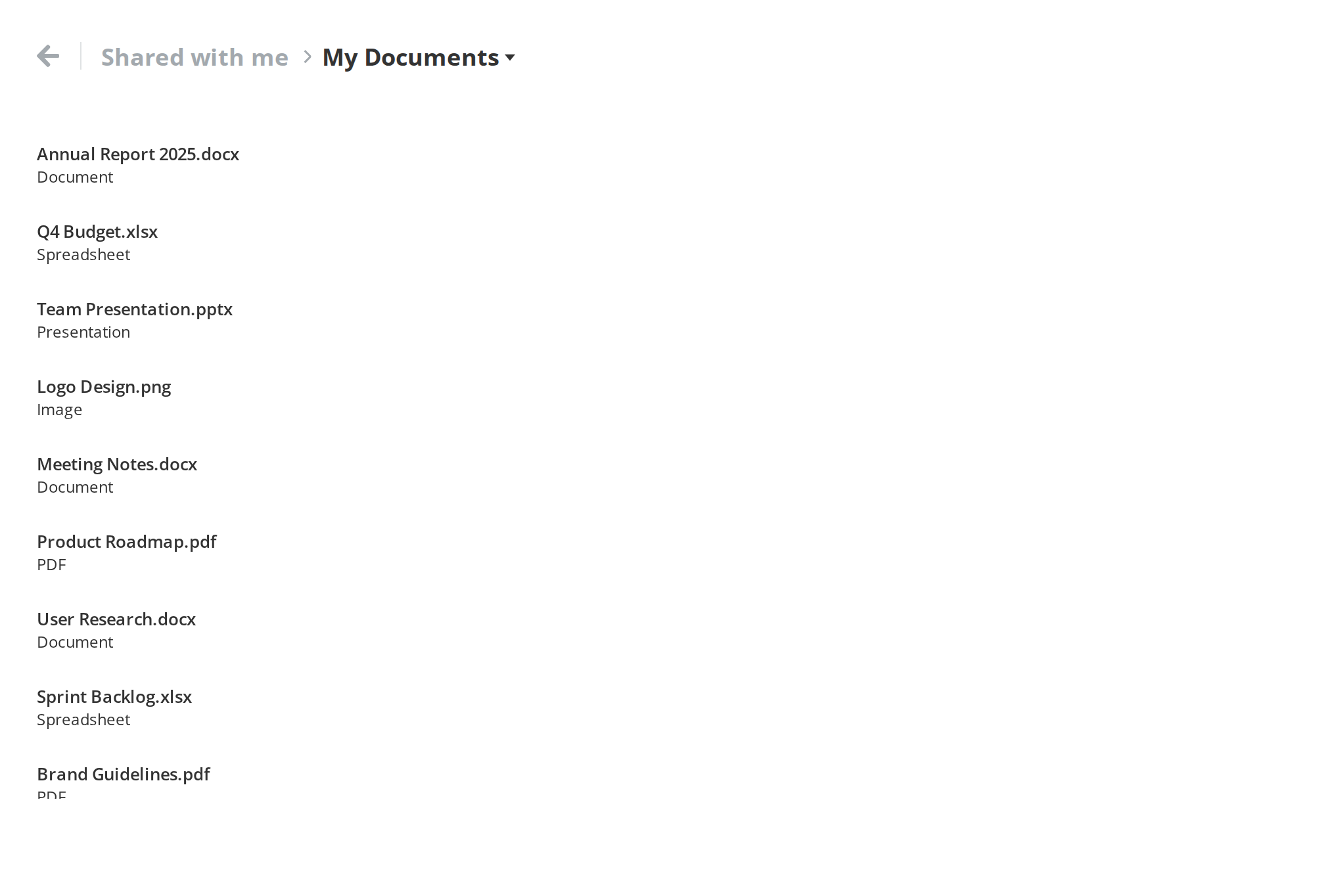

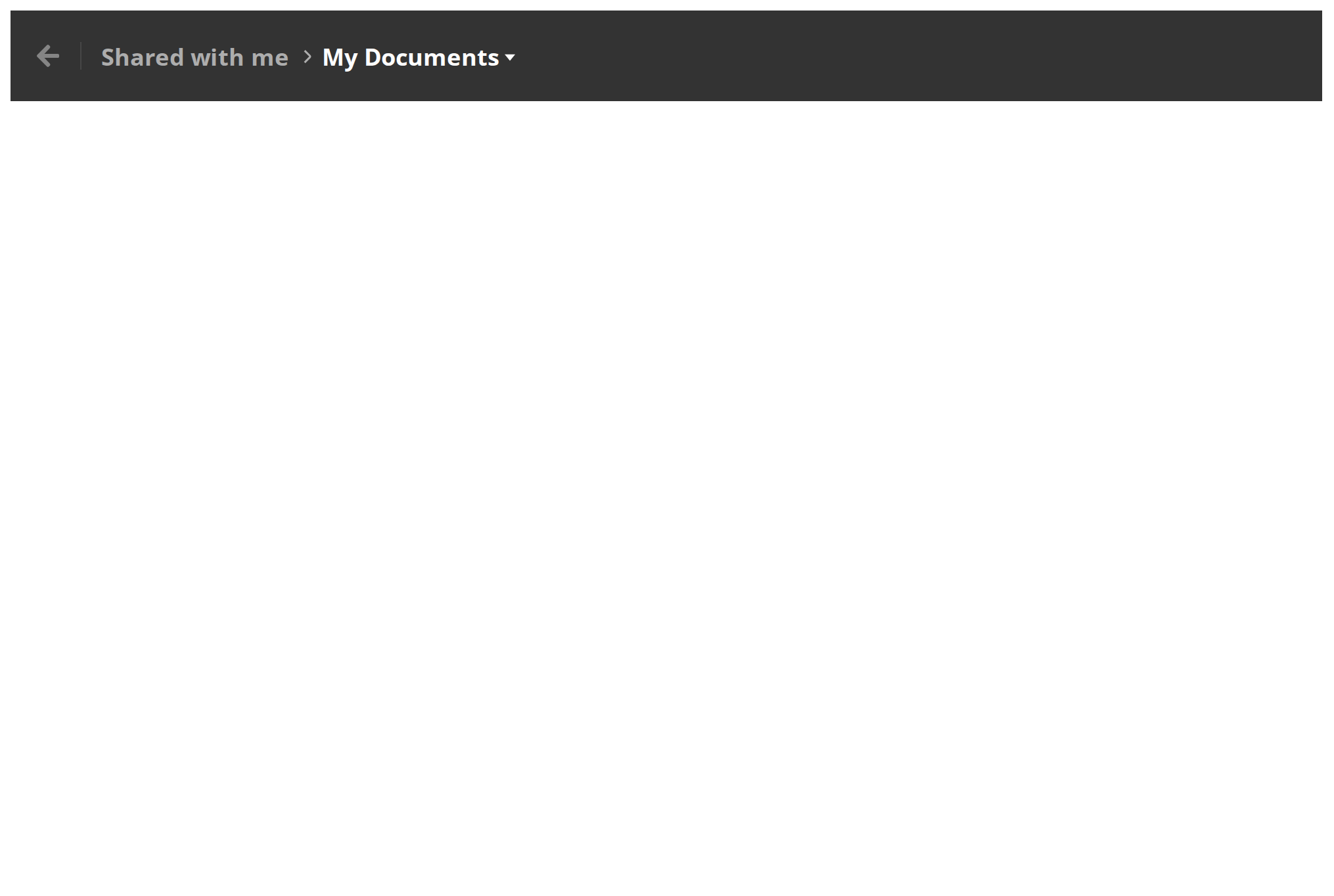

On Phone​
The page on a phone: the header and the filter bar both move into the listing and the whole page scrolls, so the rows get the full height of the screen (currentDeviceType).
On PhoneOn Phone

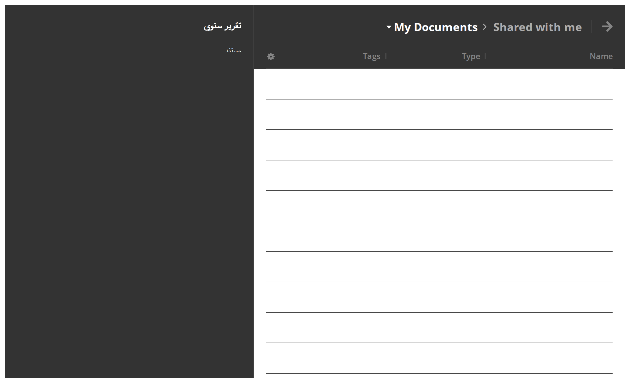

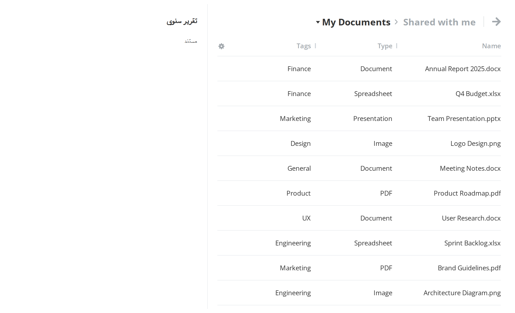

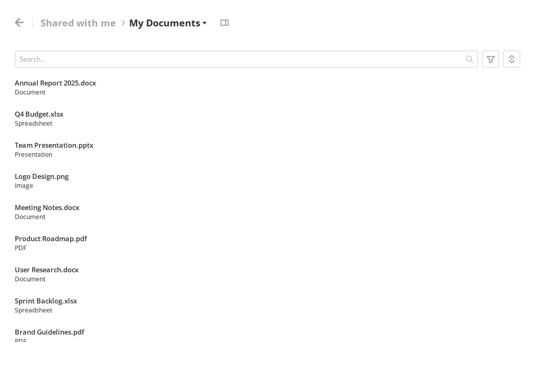

Right To Left​
The page in a right-to-left interface: the info panel opens on the left, its border moves to its right edge, and the table's columns run from the right.
Right To LeftRight To Left

Two props, not one. isInfoPanelVisible opens it and canDisplay permits it — and canDisplay has no default, so the panel stays invisible until you pass it.
import { useState } from "react";
import Section from "@onlyoffice/apps-ui-kit/components/section";
import { Text } from "@onlyoffice/apps-ui-kit/components/text";
import { Button } from "@onlyoffice/apps-ui-kit/components/button";
import { DeviceType } from "@onlyoffice/apps-ui-kit/enums";
export function PageWithInfoPanel() {
const [visible, setVisible] = useState(false);
return (
<div style={{ display: "flex", height: "100vh" }}>
<Section
withBodyScroll
settingsStudio={false}
currentDeviceType={DeviceType.desktop}
canDisplay
isInfoPanelVisible={visible}
setIsInfoPanelVisible={setVisible}
<Section.SectionHeader>
<Text fontSize="18px" fontWeight={700}>
Contracts
</Text>
</Section.SectionHeader>
<Section.SectionBody>
<Button
label={visible ? "Hide details" : "Show details"}
onClick={() => setVisible((value) => !value)}
</Section.SectionBody>
<Section.InfoPanelHeader>
<Text fontWeight={600}>Details</Text>
</Section.InfoPanelHeader>
<Section.InfoPanelBody>
<Text>Report.docx — 42 KB</Text>
</Section.InfoPanelBody>
</Section>
</div>

inert marks the section's whole subtree inert: nothing inside can be focused, clicked or reached by a screen reader. The portal uses it while the chat panel is fullscreen over the page.

export function FrozenPage({ frozen }: { frozen: boolean }) {
return (
<Section
inert={frozen}
withBodyScroll
Contracts
</Text>
<Text>Nothing here can be reached while it is frozen.</Text>
</Section>

Where the filter goes​
The filter slot moves with currentDeviceType: pinned above the scroller on a desktop, inside the body below it. stickyTableHeader moves the desktop one into the body as well, where it sticks natively and a table header can pin under it.
import { SearchInput } from "@onlyoffice/apps-ui-kit/components/search-input";
import { InputSize } from "@onlyoffice/apps-ui-kit/components/text-input";
export function FilteredPage() {
return (
<Section
withBodyScroll
stickyTableHeader
Contracts
</Text>
<Section.SectionFilter>
<SearchInput value="" size={InputSize.base} onChange={() => {}} />
</Section.SectionFilter>
<Text>Two files</Text>
</Section>
</div>
The info panel's header
The info panel's body
Section.ChatPanel
The AI chat panel, rendered only while isChatPanelAvailable

--info-panel-width400pxWidth of the info panel on a desktop
--info-panel-tablet-width480pxWidth of the info panel on a tablet, capped at the window width less 69px; on a phone the panel is always full width
--info-panel-backgroundthemeBackground of the info panel
--info-panel-border-colorthemeIts inline-start border; desktop only, the panel has no border below it
--info-panel-backdropthemeColour of the overlay behind it below the desktop breakpoint
--chat-panel-width400pxWidth of the docked chat panel
--chat-panel-backgroundthemeBackground of the chat panel
--chat-panel-border-colorthemeIts inline-start border
--chat-panel-drop-overlay-backgroundthe chat panel's ownFill of its "drop to attach" frame, drawn at 85% opacity
--chat-panel-drop-border-coloraccent; white in darkDashed border of that frame
--chat-panel-drop-inset-top69pxSpace left above that frame for the chat's own header; a phone always leaves 53px, whatever you set

  • inert is the one honest state here: it marks the whole subtree non-focusable and hides it from assistive technology.
