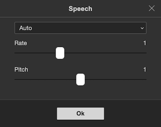

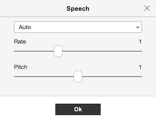

Let’s have a look at the Speech plugin. The plugin itself does not need a visual window for converting the selected text into speech as it can be done just pressing a single button, but its settings (the speech language, rate and pitch) and an About window must be visual. So we will need to have at least two plugin variations (text conversion itself and settings), or three, in case we want to add an About window with the information about the plugin and its authors or the software used for the plugin creation.
Invisible pluginInvisible plugin Speech settingsSpeech settings
