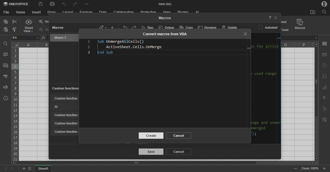

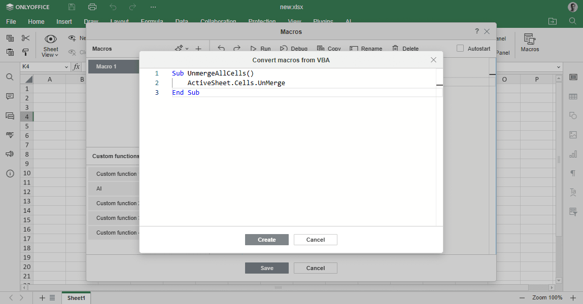

For example, you have a simple VBA macro that unmerges all merged cells in the active sheet:
Sub UnmergeAllCells()
ActiveSheet.Cells.UnMerge
End Sub
You can paste this VBA code into the AI plugin converter. The plugin will return the following JavaScript macro:
