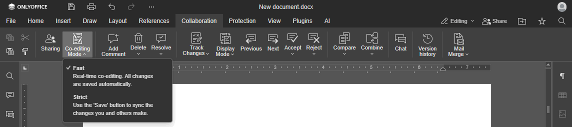

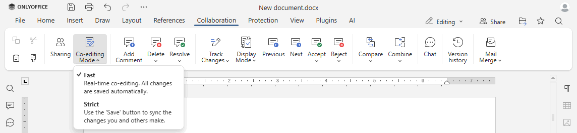

coEditing​
type: object
The co-editing mode and the possibility to change it. This parameter is used to apply the co-editing and viewing modes.
Example:
"mode": "fast",
"change": true
coEditing.mode​
type: "fast" | "strict" | default: "fast"
The co-editing mode.
note
In case mode setting is changed in the editor interface, it will be stored in the browser local storage and will overwrite any values sent as the editorConfig.coEditing.mode parameter. The fast mode requires autosave to be enabled, so customization.autosave will be forced to true if it is set to false.
Example: "fast"
coEditing.change​
type: boolean | default: true
Whether to allow changing the co-editing mode in the editor interface.
Example: true
Coediting modeCoediting mode

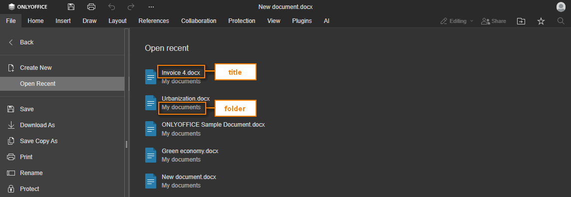

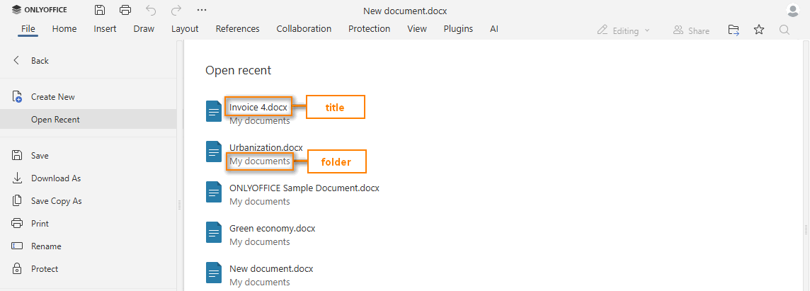

recent​
type: object[]
The presence or absence of the documents in the Open Recent... menu option.
Example:
"folder": "Example Files",
"title": "exampledocument1.docx",
"url": "https://example.com/exampledocument1.docx"
recent.folder​
type: string
The folder where the document is stored. Can be empty if the document is in the root folder.
Example: "Example Files"
recent.title​
type: string
The document title that will be displayed in the Open Recent... menu option.
Example: "exampledocument1.docx"
recent.url​
type: string
The absolute URL to the document where it is stored.
Example: "https://example.com/exampledocument1.docx"
Recent documentsRecent documents
