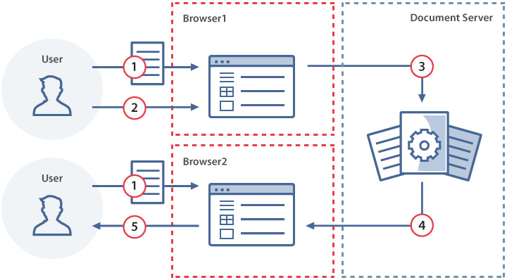

The figure and steps below explain how a document is co-edited in ONLYOFFICE Docs.
Co-editing scheme
  1. user 1 and user 2 both open the same document in the document editor — that is, their configs contain the same document.key.
  2. user 1 makes changes to the opened document.
  3. The document editor sends changes made by user 1 to the document editing service.
  4. The document editing service sends the changes made by user 1 to the user 2 document editor.
  5. Now these changes become visible to user 2.

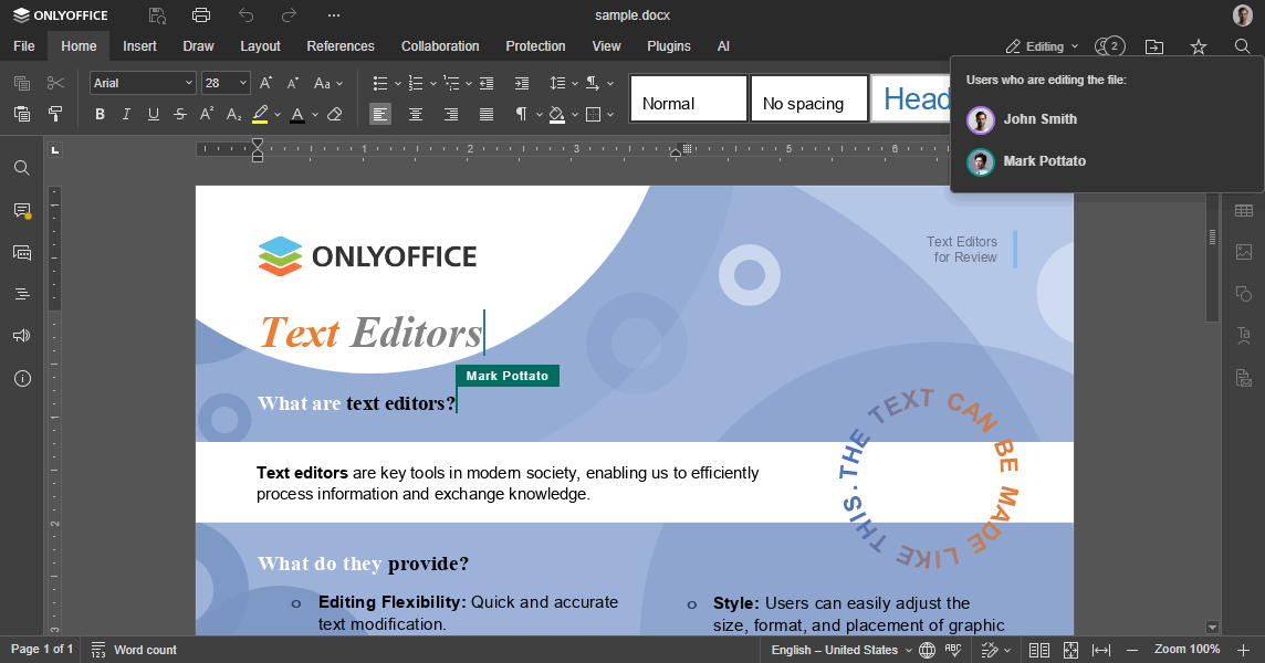

  6. Open the same .html file in a second browser tab. Because both tabs use the same document key, the document editing service connects them into a single co-editing session — you are now co-editing with yourself.

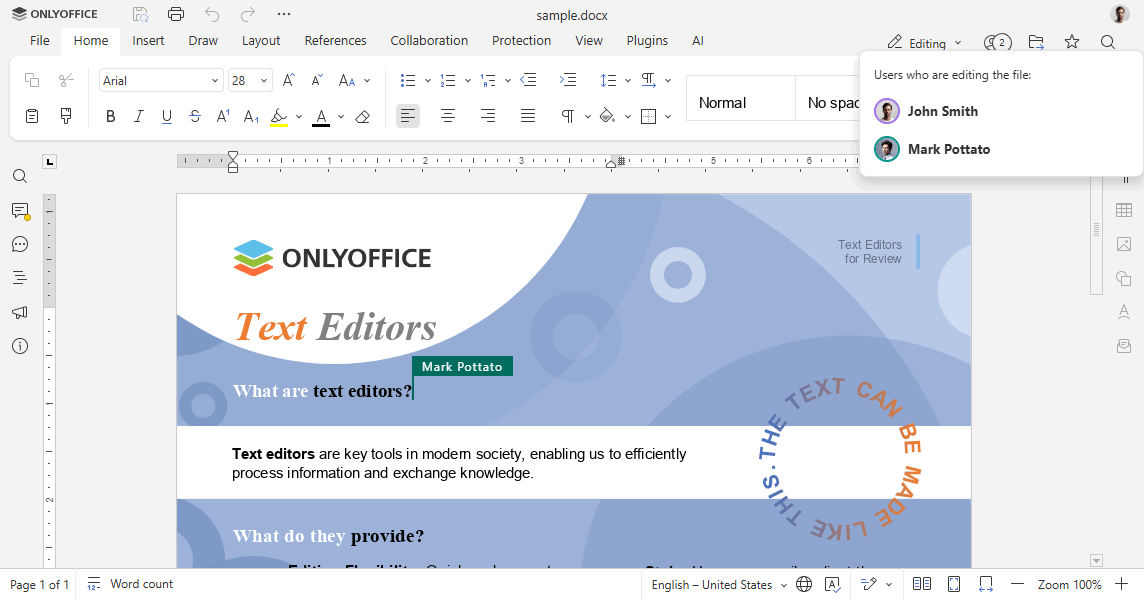

There are two modes to collaborate on documents in real time — Fast and Strict.
You can change the co-editing mode using the editorConfig.coEditing parameter:
const config = {
editorConfig: {
coEditing: {
mode: "fast",
change: true,

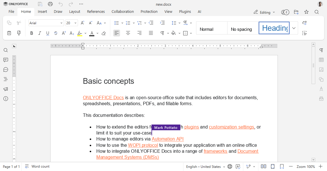

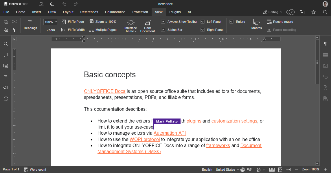

Fast mode​
Fast mode is the default. All changes are sent to other users in real time — you see their cursors and name tooltips as they edit the document. Changes are saved automatically, and redo is not available.
Fast modeFast mode

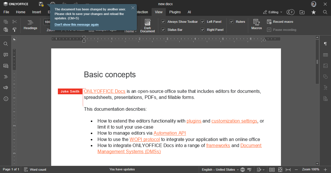

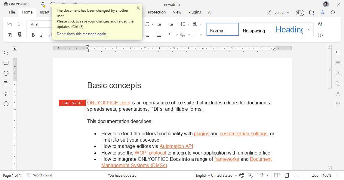

Strict mode​
In Strict mode, each user works in an isolated session. Changes made by others stay hidden until you click Save. While several users are editing simultaneously, their regions are marked with dashed lines of different colors.
After you click Save, the other users receive a notification about updates. To accept them and send your own changes, click the Save updates button in the top-left corner of the toolbar. The accepted updates are highlighted.
